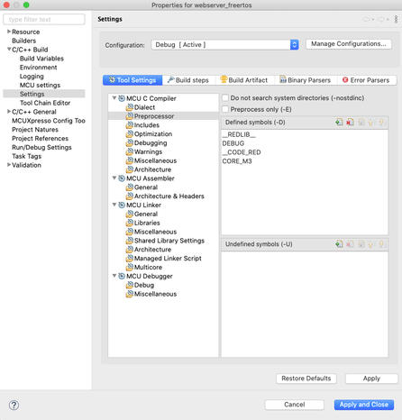

Hi. I need to use LPCOpen and CMSIS together. My webserver code is written at LWIP lpcopen and my main code written at cmsis. when ı add webserver to main code, ethernet init function is halted and debugger is freeze.
I think, that's not the only the problem, is there any some major problem ?
How can ı solved this problem? How can ı run lwip server at lpcopen with cmsis.
I add some photo from options,codes and workspace.
Debugger is halted at pENET->MAC.MAC1 = ENET_MAC1_PARF;

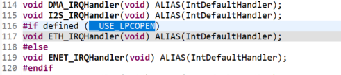

Hi Ramazan,
In case you're using CMSIS in the LPCOpen Library you should eliminate the preprocessor declaration
__USE_LPCOPEN, this due to the discrepancy in the IRQ name, in the CMSIS library is called differently.
Let me know if this helps you.
