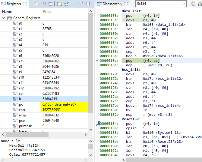

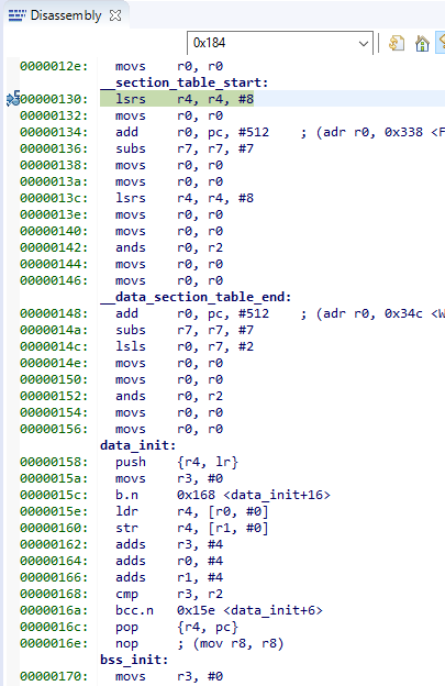

  • I tried following the start-up procedure line by line. My first surprise is that the CPU doesn't go directly to the ResetISR as I thought it should be (at least it doesn't stop at eh breakpoint). It stops at the __section_table_start which is one of the first lines after the IVT. Then in data_init is does a "push {r4,lr}" and later "pop {r4, pc}". "lr" has an address that belongs to SRAM, so the program goes there (It has this value since the first breakpoint at least, and it's there every time I've tried). After that instruction it enters in the HardFault_Handler.

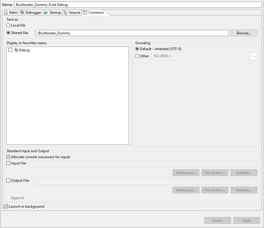

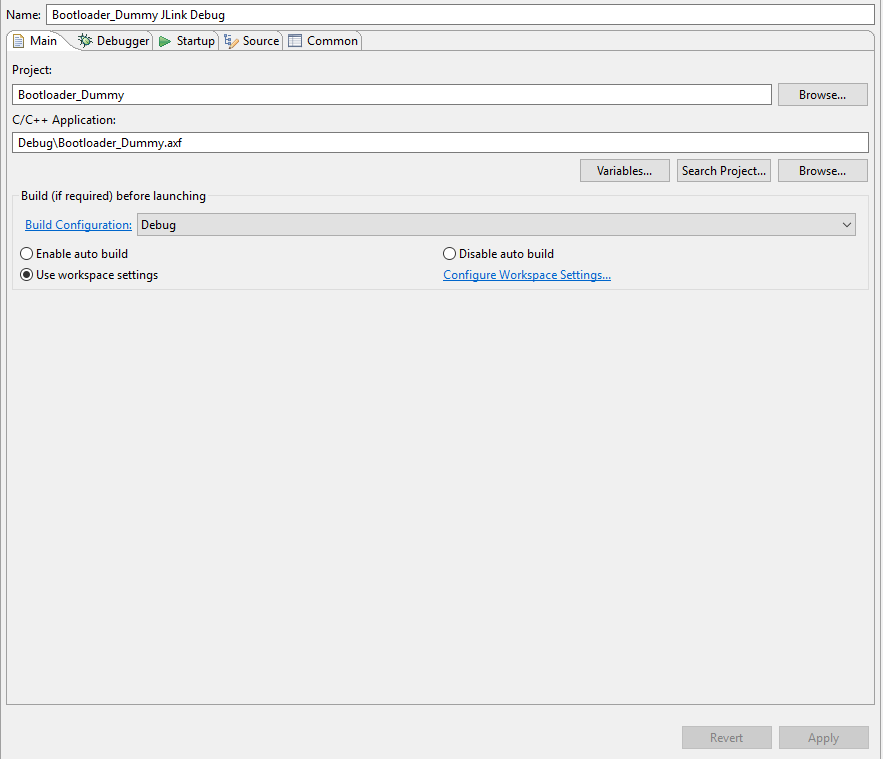

Finally, this is my Debug configuration:
