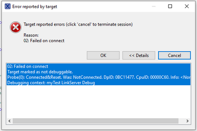

now i have tried to install the IDE the 3rd time. to inform you about the error mesages
if i stop my debug session
next debugging doesnt work and shows 3 error Windows:
Windows 1: Error reported by target
02: Failed on connect
Could not connect to core.
31: No connection to chips's debug port
Debugging contexte: project1 LinkServer Debug
Window2: LinkServer
17^error,msg?"Remote communication error. Target disconnected,: Success."
Reason:
Failed to execute MI command:
-target-select extended-remote | crt_emu_cm_redlink -msg-port=49873 -g -mi -2
-pLPC1768 -vendor=NXP  --reset=VECTRESET -ProbeHandle=1 -CorIndex=0
--flash-driver LPC175x_6x_512.cfx --telnet 3330
Error message from debugger back end_
Remote communication error. Target disconnetcted.: Success.
Window 3:  Problem Occured
'Launching project1 LinkServer Debug' has encountered a
problem
Error in final launch sequence
Consolen output:
MCUXpresso IDE RedlinkMulti Driver v10.3 (Feb  7 2019 22:50:02 - crt_emu_cm_redlink build 760)
Found part description in XML file nxp_lpc17xx.xme
(  5) Remote configuration complete
Reconnected to existing link server
Connecting to probe 1 core 0 (using server started externally) gave 'Ee(42). Could not connect to core.'
Server OK but no connection to probe 1 core 0 (after 3 attempts) - Ee(42). Could not connect to core.
Failed on connect: Ee(42). Could not connect to core.
No connection to chip's debug port
The Button "Clean Up Debug" dont change the behavior.
a next test with another project has the same results.
i cant locate the problem
Debugging all projects with the MCUXPresso IDE Version 3.0 has no problems
Siro
