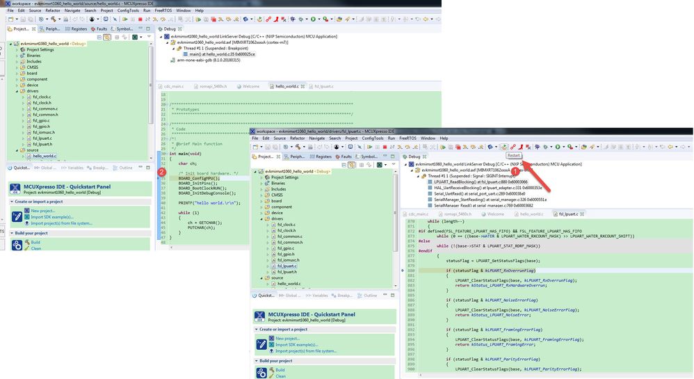

Hi Gents,
Question on using MCUexpressoIDE with a RT1062 SoM that uses EcoXiP external flash...
If I'm running in debug mode and I click on the Restart icon it doesn't restart back at the first instruction in main(). I have to close out of the debug session and start back up. Any thoughts as to how to get this working as it should?
Below is my Debug Console output:
004A000 done 100% (303104 out of 301392)
Erased/Wrote sector 0-73 with 301392 bytes in 16769msec
Closing flash driver MIMXRT1050-EcoXiP_ATXP032.cfx
Flash Write Done
Flash Program Summary: 301392 bytes in 16.77 seconds (17.55 KB/sec)
Starting execution using core reset and halt target
Note - core reset leaves VTOR at 0x200000 (not 0x60000000 which a booted image might assume)
Stopped (Was Reset) [Reset from Unknown]
Stopped: Breakpoint #1
[I CLICK ON RESTART HERE]
Stopped: Halt
nonstop - GDB killing (vKill) non-existent PID 0xA410 (killing anyway)

Hi Mike Spenard,
It seems bit weird, to figure it out, I'd like to replicate the issue on my site, so I was wondering if you can tell me which exactly demo you ran, is it from the SDK library?
Looking forward to your reply.

jeremyzhou
Thanks for your reply.
I've run the hello_world on the MIMXRT1062 board, during the debugging, the Restart feature works well,
thus I don't encounter the phenomenon you mentioned.
In the user guide, it just illustrates the process of debugging of i.MX RT1052,  for i.MX RT1062, it's a bit different, it's hard to say that the MIMXRT1050-EcoXiP_ATXP032.cfx is also suited for the i.MX RT1062.
