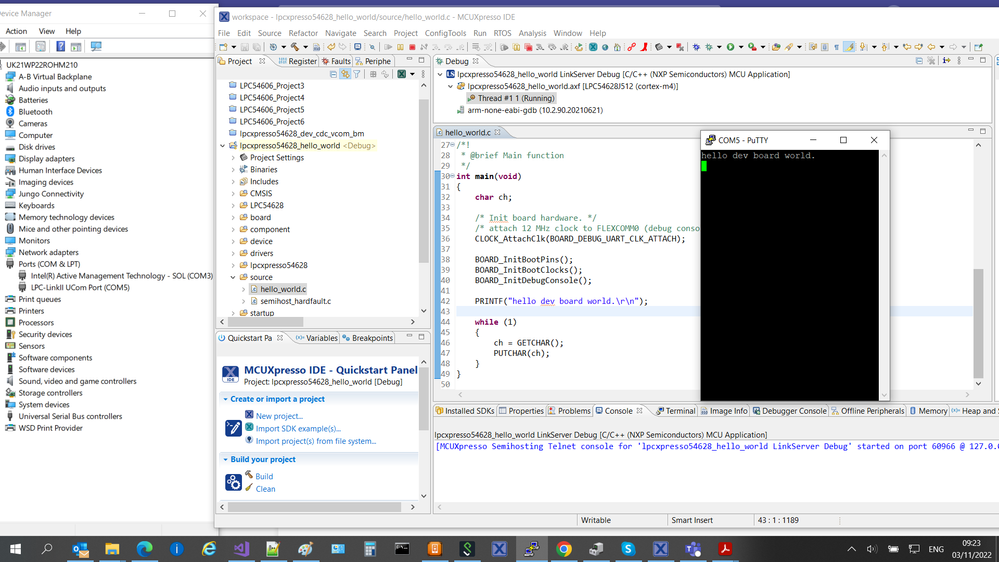

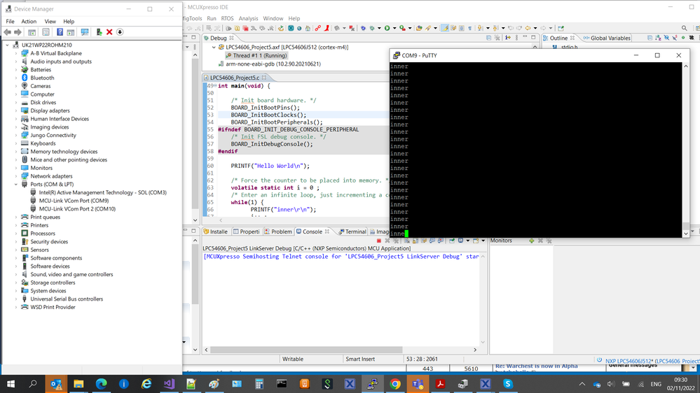

I had a development board, and it made COM Port 9.
My custom board with a debug probe made COM Port 10.
I made a new project for my custom board, and changed the debug console under 'Peripherals->Compoents->Utilities'. My board uses FLEXCOMM5. I successfully updated my code and changed to that.
Now if I build and debug my code, it finds the LinkServer, but nothing comes out of the debug console window.
If I open putty, the COM Port 9 is showing all of the debug messages.
I can't find a way to change this anywhere in the MCUXpresso IDE...?
I've tried deleting COM Ports from device manger (Windows10).
I tried deleting the project .launch file.

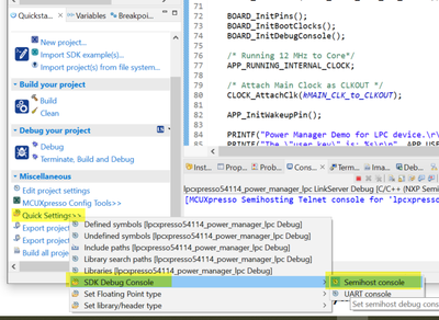

Hello @rjleiser ,
"But the point is that the 'debug console' shows nothing. "
->> Because have configured to UART console, there is message in putty.
If you want to print to Debug Console, choose "Semihost console" as below:

rjleiser
Yes, the dev board was NOT connected. I hadn't cinnected it in a long time.
If I now go back to the dev board ONLY, I get COM5 and it has the same problem, only putty can see COM5 messages:
dev board only connecteddev board only connected
If I go back to my custom board, then I have both COM9 and COM10.
When I first had just the dev board, there was only COM9 and the 'debug console' worked.

rjleiser
Yes TX\RX are configured, otherwise there would be NO messages anywhere.
It would seem FlexComm5 is using COMport9.
But the point is that the 'debug console' shows nothing. And it now shows nothing on my custom board AND my development board.
If I disconnect my debug probe, then both COM9 and & COM10 disappear. And they both come back with a reconnection.
Having said that, it does not explain why my development board doesn't work at all, and there is only 1 COMPort for that.

Hello @rjleiser ,

rjleiser
Yes, thankyou. That worked for my development baord. I cannot test my custom board atm.
