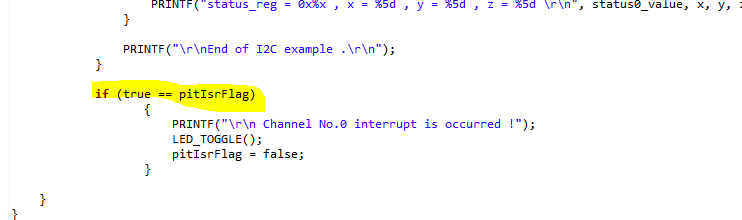

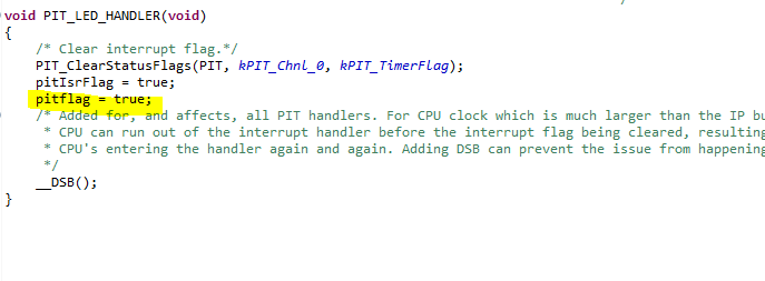

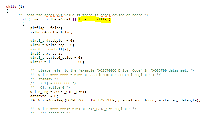

I have tested this from my end with no problem. However, I did make a few modifications.
First, some good practices when doing interrupts is that within the handler try to keep it to a minimum. This will help speed things up and simplify what is occurring, so try to only use flags in a handler instead of a whole function that calls others. This is because it might be too fast that by the time the interrupt is triggered again you haven't finished requesting the data from I2C module.
Basically, what I did is I took the original example from our SDK for i2c_read_accel_value_transfer and the pit and merged them.
I took the i2c code that prints the values and placed it inside the main while loop and added a flag so it only enters when the pit flag is enabled.
In my pit handler I added this flag so it enables it every 20ms.
I also added the original led function from the pit example of the SDK in the while loop so I know that the pit is actually working.
You can try first with the pit configuration that is 1 second and then change it to your desired time. Could you please try it like this and see if it works the same for you?
