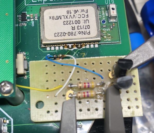

I don't want to get into too much of the BT Module I'm communicating with but I think I need to explain what's happening.   The issue is that straight from the box the module runs at 19,200bps and I want to run it normally at 921,600bps.  I can set the datarate of the module that is set in EEPROM (so later boots are at full speed) but for the first boot it is at 19,200bps.
On boot, I do a test communication at 921,600bps as this is the datarate the module will be running at every time except the first time - if I get a good reply packet then I just continue with the rest of the application.
If I don't get a good reply, I cycle power on the unit and change the Kinetis baud rate to 19,200bps and then go through a process where I set the baud rate to 921,600bps.  Since RTOS_UART_Receive is no longer working, this process can't go forwards.

I figured out the problem - The TX line from the BT Module is being dropped for what I guess is too long during the process in which the baud rate of the module is being changed.
I saw it on my oscilloscope when I triggered on the RX line into the Kinetis from the BT Module - there was a 50ms long low after the ACK reply saying the module had changed it's baud rate.  Not listed on the (admittedly poor) datasheet.  This is obviously not an issue with the Bare Metal implementation.
Ideas on how to work with this on the FreeRTOS implementation?  There's actually three parts to this question, the first is when I have to change the baud rate, how do I avoid this issue with the FreeRTOS driver.  The second part is when I go into low-power mode on the product.  I'm turning off power to the module when the product goes to sleep and this will drop the RX line coming in to the Kinetis - I do have a 100k pull up on the line but this is overpowered by the BT Module in both cases.  The BT Module does have a "Sleep Mode" but this reduces it's current draw to 0.9mA which isn't all that great.
I think the best solution to the first two problems is to run the TX lline from the BT Module through an OR gate which I can control as "high" when the TX line goes low.  Could I ask if the line going low is interpreted as a "break" and could be handled in software (which would be the best solution)?

There is good news!  Yesterday I built a simple two transistor Open-Collector buffer with the ability to force the output line to be always high from an IO pin.  Sorry that the picture below is from my camera and is a bit fuzzy (and still has the oscillocope scope probes on it).
Creating the circuit turned out to be a bit more work than I expected - I guess it's because I used bipoar NPN transistors, and there is more capacitance in the lines that I would have expected.  The current limiting resistors for the transistor bases turned out to be 4k7 and the pull up on the RX line going to the MK22 needed to be 2k0 in order to get reasonably good quality edges on the signals.  This was a surprise because the datasheet indicates that the input capacitance on the DI/DO pins is 7pF but looking at the oscilloscope traces to measure the rise time constant, the nets were calculated to have an input capacitance of 23pF.
