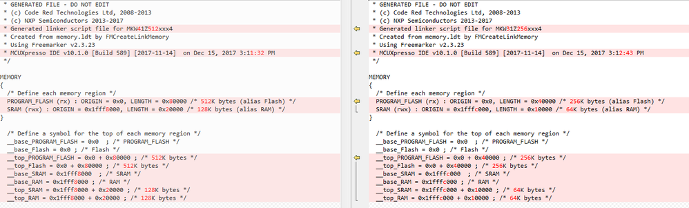

I spent some more time solving this issue and I recognized, that an empty project has another structure than the heart rate monitor example. At the example they use a self made linker file MKW41Z512xxx4_connectivity.ld. But generating a new empty project choosing the MKW31Z family generate 3 linker files in the folder "Debug".
However, do you offer any linkerfile for the MKW31Z which I could replace with the existing MKW41Z512xxx4_connectivity.ld ? The structure of this file should be same, but other section because the memory is limited. Editing the MKW41Z512xxx4_connectivity.ld file might be dangerous and difficult to get it right, I think.

Hello Robert,
Does your project for kw41 can work well already on MCUXPresso IDE ?
If yes,  I recommend you compare the flash memory between the two chips , then change the linker file for KW41 to
KW31.  Or create a new project of KW31, refer to Erich's blog and kw41 linker file to configure.
For the two chips' flash, just the size is different, we can see from the default three linker files, only the
"Debug_memory.ld" distinction.
Alice
