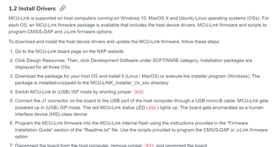

Hello @leannee
Do you refer to the steps below?
What about the version of your board? The version of MCU-link installer? Please take a video about the steps on your side.

Yes, I refer to these steps. Which I follow to the dot. The board is in ISP mode: D16 is on, the board is enumerated as HID device (VID 0x1FC9, PID 0x0021).
I have no idea about the version of the board. Although the marking says WO-**-2308, which I guess yyww?So it should be fresh. Both MCUs are from last year, based on markings.
I have tried version 3.108 of MCULink installer.
I repeat, I have successfully updated the MCULink firmware to version 3.108 using Ubuntu.

Hello @leannee
I tested on my side, win10, MCULink firmware to version 3.108 /3.122, there is no problem:
Do you have other win10 PC, you can test with another PC.
