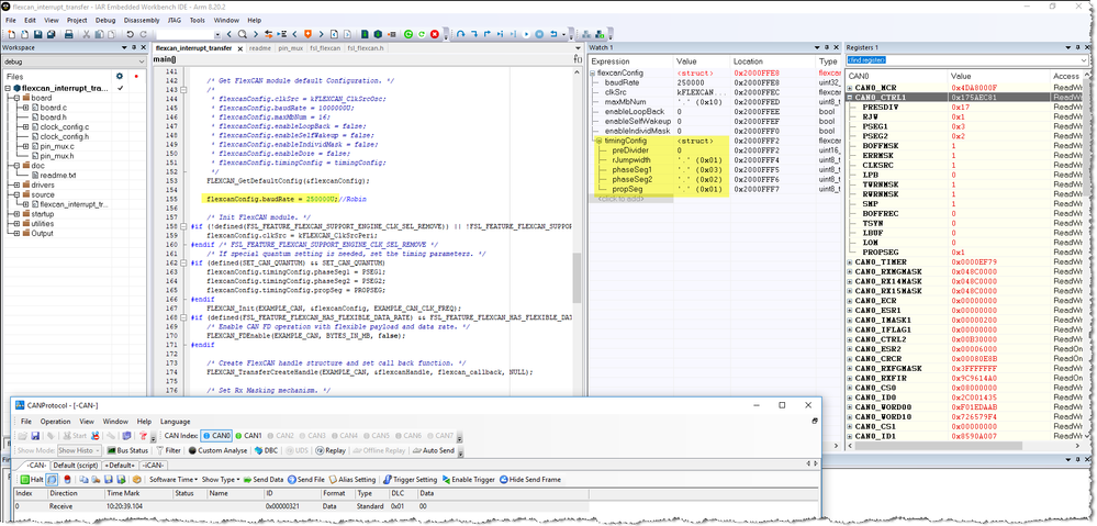

Robin_Shen
Hi  Alexandre V.D.P.
I just modify the flexcanConfig.baudRate = 250000U;
The Node A of twrk21f120m_flexcan_interrupt_transfer seems able to send the first CAN message.
I have only one TWR-K21F120M board at the moment, so test it with CAN analyzer. Please make sure that both tower board was flashed with the newer baudrate program.
Robin
