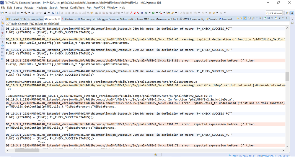

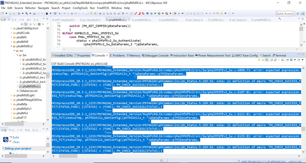

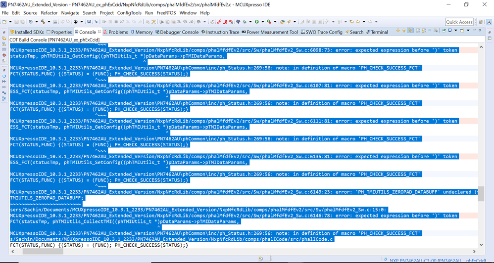

Hi @Kan_Li,
I have tried to do it in the PN7462AU NFC reader library extend version with the Mifare Desfire EV2 demo, which is requested from the docstore.
After doing a lots effort on it I am unable to get the use of it, because it give many error after defining the macros in the APP_NxpBuild.h file with "NXPBUILD__PHAL_MFDFEV2_SW" ,   " NXPBUILD__PHAL_MFDFEV2 ".
It gives so many error & I am unable to fix it.
So can please let me know that how do I declare macros for it and for other setting(setting up project in such to get the use of it).
I am attaching a image file & also the log details through which you can clearly check the error, I hope it helps to understand the error better. And will great if you can share the some details to enable those(Mifare Ev2 4k card sw files) files.

Kan_Li
Hi Manva,
Base on the demo of "NfcrdlibEx10_MIFAREDESFire", Please add the following definitions in the APP_NxpBuild.h file:
#define NXPBUILD__PHAL_MFDFEV2_SW
#define NXPBUILD__PH_NDA_MFDFEV2
#define NXPBUILD__PHAL_VCA_SW
#define NXPBUILD__PH_TMIUTILS
 and please also add the following definition in the file of "/NfcrdlibEx10_MIFAREDESFire/PN7462AU/phCommon/inc/ph_Status.h":
#define PH_COMP_TMIUTILS                0xE500U /**< TMI Utilities Code. */
Hope that helps,
Kan
