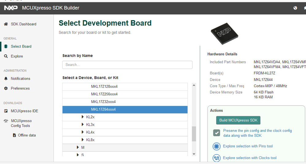

Now I use MCU MKL17Z64VFM4 to create a new project:
1. Use online MCUXpresso SDK Builder to select mcu MKL17Z64xxx4/use pin toll config pin/use clock tool config clock, named the sdk as SDK_2.6.0_MKL17Z64xxx4 then Build MCUXpresso SDK, Down the SDK as three folders,SDK_2.6.0_MKL17Z64xxx4.zip/SDK_2.6.0_MKL17Z64xxx4_doc.zip/SDK_2.6.0_MKL17Z64xxx4_ConfigTools_data
2. Add the sdk SDK_2.6.0_mkl17z64xxx4.zip to MCUXpresso IDE.
3.In MCUXpresso IDE-QuickStart select "Import SDK example(s)" I can not select MKL17Z64xxx4 but only can select MKL27Z64xxx4 to create a project. The project use mcu MKL27Z64xxx4, if I want to use MKL17Z64xxx4 only to change the mcu? The sdk can only created by mcu which have a board,It is too strange, I never got those trouble when I use other mcus.

Hi Wenfang,
KL17 hasn't FRDM or TWR board. So, in it's SDK there isn't MCUXpresso demo. KL17 is a KL27 without USB. You can use KL27 demo to test. When you will create a KL17 project in MCUXpresso, the only way is QuickStart panel->New project.

Hi Jing:
   Ihave already creat new KL17Z64VFM4 project: Qickstart Create or Import a project->New Project.
It seems that every mcu must create a SDK using SDK builder before create a project.
    I use KL17Z64VFM4 project within MCUXpresso IDE. When I use the config tools in the MCUXpresso IDE to config the project , there is a warning like below:
   工具链(IDT)工程中,该版本的GPIO Driver不被支持,所需的:2.2.1,实际的:2.3.2
   but the compile and build is OK, is there any hidden danger about this?
