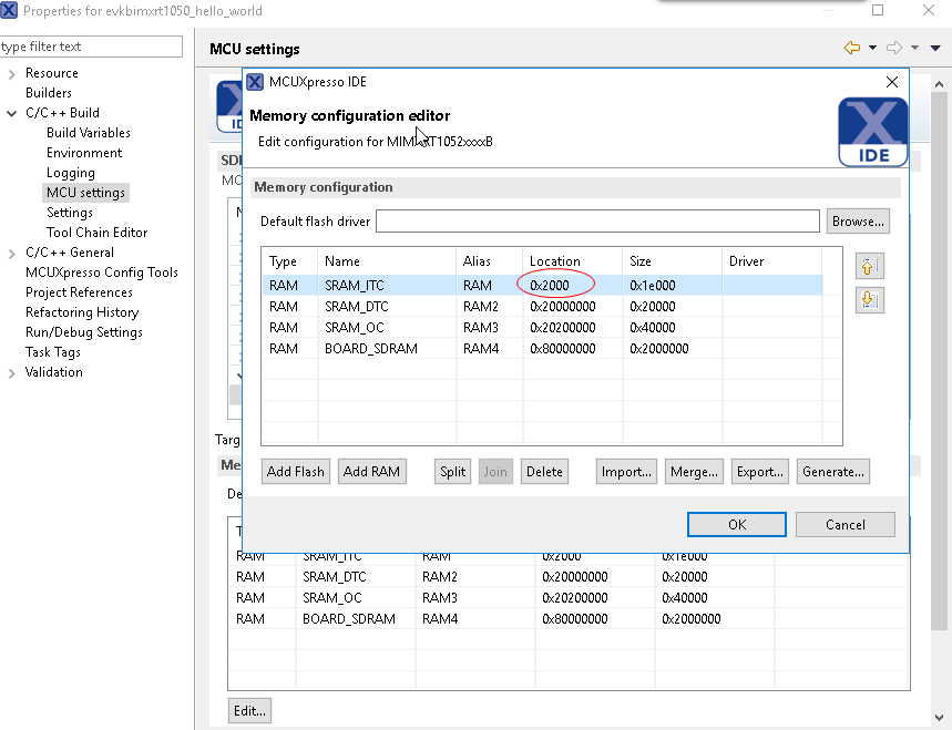

Did anyone try to program boot image created under MCUXpresso into SDCard ? My goal is to boot from eMMC but as first step I would like to boot from sdcard and later switch to eMMC. I successfuly managed to create boot_image.sb file and I am able to program it into SDCard but after reconfiguring boot pins and reset program won't boot. I am following steps described in AN12107 but unfortunately project configure related steps are for IAR.
My configuration:
- application code executed from DTCM
- I modified linker script to put reset vector and rest of the app code under 0x20002000 address
- in "imx-dtcm-unsigned.bm" file i set startAddress = 0x20000000 and entryPointAddress = 0x20002000 (that's where vectors are)
- I am using "program_sdcard_image.bd" without any custom changes
- I'm using hello_blinky example project as base
EDIT: After some reading and searching I believe entryPointAddress should be set to 0x20002000 (vectors array start address). Still I don't know if I should set startAddress to 0x20000000  or to different address ? I also recreated example SD card boot example from AN12107(section 3.5) using ITCM but I'm facing the same problem, app won't boot. Why is it necessary to set startAddress to 0x8000 ? Why it can't be beginning of ITCM memory ?
I would be grateful for any info, example or simple tutorial.
Thanks in advance

Hello Mateusz Piesta,
I test it on my side today , it can work well.
MCUXpresso IDE v10.2.0_759
SDK v2.4
For the SDK demo of "hello_world", only change memory configuration:
Please pay attention the start address of application is 0x2000,.
Then refer to AN12107 steps to do .
If have any problem about this, you can share it with us.
Hope it helps,
TIC
Please change startAddress from 0x8000 to 0x1000 to have a try on with TICM proejct. . https://community.nxp.com/message/997860
If still can't work, please tell me the version of SDK , and MCUXpresso IDE.
