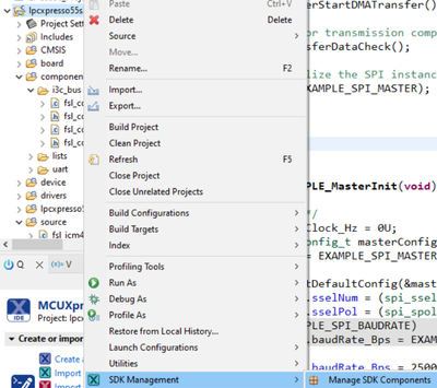

I have migrated from CodeWarrior to MCUXpresso and I am using a FRDM-KL26Z board and have loaded the SKD. I suppose I have, in the past, been used to just clicking on an item in the ProcessorExpert library, edit the properties and there it is - done. But how do I do it in MCUX? I know that ProcessorExpert does not have an equivalent in MCUX.
In particular I want to add I2C into a new project (which I have created) but I don't know what to do next. I have looked at a couple of examples which confused me even more., What I really need something like :-
"Adding On-chip Components for Dummies"
Can someone point me in the right direction?
1,359 Views
Pavel_Hernandez
Hello, my name is Pavel, and I will be supporting you.
For add the component follow the image example.
Select your Project > SDK Manager > Manage SDK.
