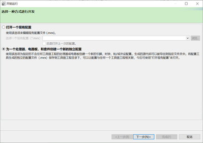

I use config tools(v13.1-) to export SDK example(keil  project), but v14 seems not same.
How can I do it now or it's moved to another place?

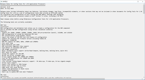

lukastyc
It seems you are using the different product Config Tools for i.MX, that do NOT support clone(create standalone project) from SDK example.
Please use MCUXpresso Config Tools.

lukastyc
Create a new configuration and project based on SDK example is on the same place in v13(v13.1) and v14.
Could you please provide us more details or screen shots about your issue?
Thank you

shizj
Thanks reply.
It looks difference with yours.

lukastyc
