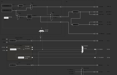

Hi Team,
A customer reported this issue regarding the clock config tool.
Attached you can also find a screenshot of the gibberish in the clock diagram. This occurs on any appearance mode (light or dark) and any installed SDK (LPC and MKW).
Currently I have the following SDK installed:
  • \SDK_2.2.3_FRDM-KW41Z.zip
  • \SDK_2.8.2_LPCXpresso55S69.zip
  • IDE version 11.2.1
Any ideas on to what might be causing this,
Nada

Hello Nada,
it seems like already reported issue here https://community.nxp.com/t5/MCUXpresso-Config-Tools/Clock-diagram-problem/m-p/1198989/highlight/fal...
Could you please run mcuxpresso from command line
mcuxpressoide.exe -nl en
 to see if the problem is not caused by localization?
