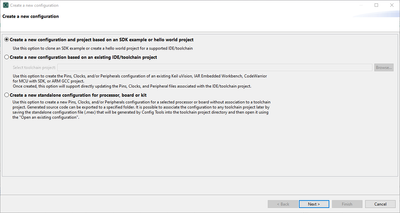

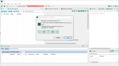

I've installed MCuXpresso Config Tools Versino 11.0
and I'm attempting to start a new configuration: File->New -> Create a new configuration
I select the Create a new standalone configuration for processor, board or kit

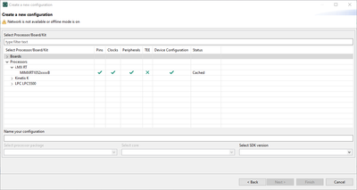

and the only i.MX RT allowed to choose from is the MIMXRT1052.
How do I get this utility to allow ALL the i.MX controllers?
2,893 Views
Petr_H
As you can see the exclamation mark and message in the top-left part of the dialog, the tool is not able to access the network. Config tools need internet connection to access the list of the processors and download additional data for the selected processor.
Do you have the internet connection available on the machine?

Thanks.  I down loaded the RT1062 support file and now I can review/modify the .mex file!
