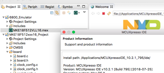

I used the Mac OS version of the IDE (10.2.1_795) without any problem.

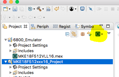

Your attached project does not have the board/ folder, so the config tools cannot be started for this project (configuration is parsed from pins and clocks C sources in that folder). Anyway, I created bare project, clicked in Project view on COnfig Tools icon - see screenshot:
The MEX file has been created based on the configuration stored in C sources (in YAML format).

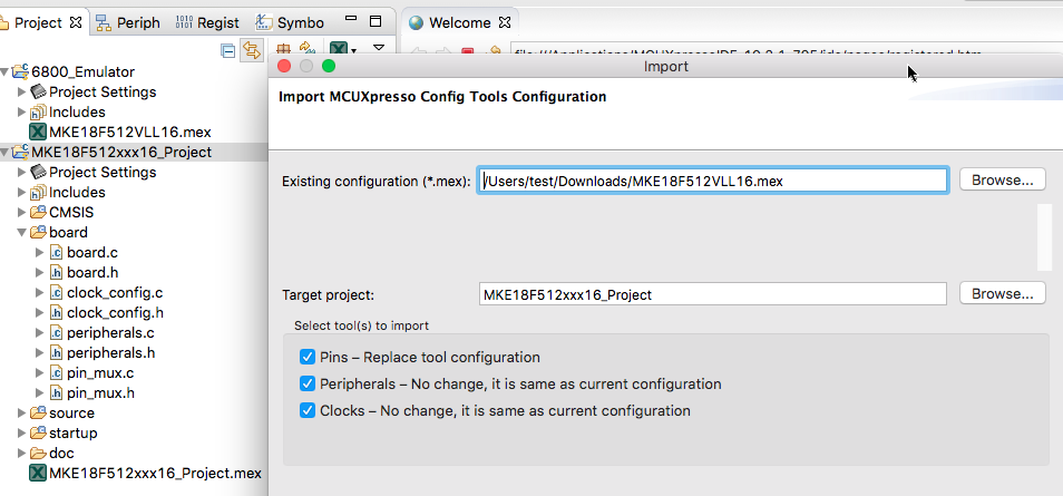

Then I'm able to import configuration from your mex:
Did you follow the same steps?
By the way, if you want to use complete configuration from stand-alone version, you can just delete the MEX file inside the eclipse project and simply copy&paste your MEX into the project, it will be used by the config tools.
