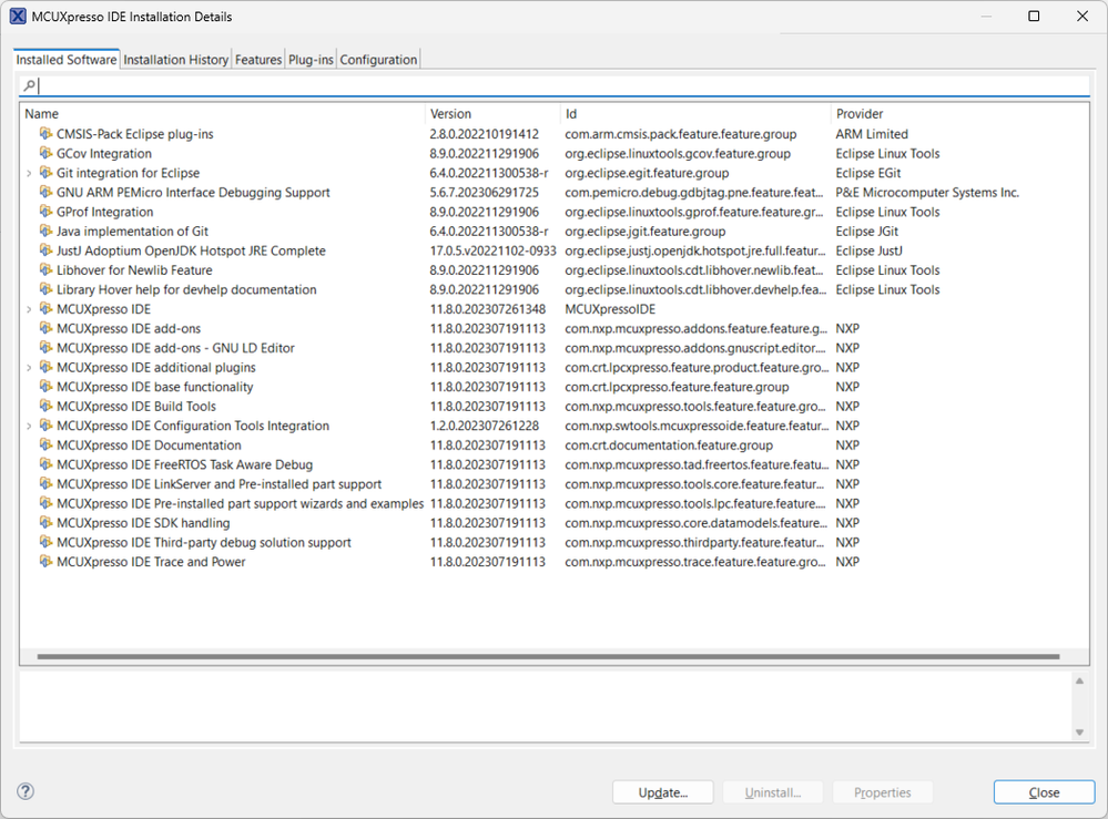

Hi Petr,
thanks a lot. here are the versions I'm currently running,
I don't seem to be able to do an update, do you confirm these are the latests one, or should I download the standalone config tool or something ?

4,125 次查看
Petr_H
I recommend to download and install the latest recently released MCUXpresso IDE 11.10 that contains also the latest MCUXpresso Config Tools. It's available for free at our website:
https://www.nxp.com/webapp/swlicensing/sso/downloadSoftware.sp?catid=MCUXPRESSO
Petr Hradsky
MCUXpresso Config Tools Team
4,139 次查看
Petr_H
It seems that the problem is related to older version of the Config tools that yo are using. We have tried it in the current version and the warnings are not there anymore. Could you please install the latest MCUXpresso Config Tools or MCUXpressoIDE (if you are using integrated config tools there) ?
