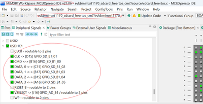

I import an SDK demo "evkbmimxrt1170_sdcard_freertos_cm7", in this demo, There is  USDHC driver available in the config tool.
IDE version: MCUXPresso IDE 25.6
SDK version: MIMXRT1170-EVKB 25.6
I think you can refer to this demo.
Wish it helps you.

Hi MayLiu, thanks for the reply. Your screenshot shows the pin configuration, I was referring to the peripheral driver. I don't see the peripheral listed in the peripheral view.
Many thanks
