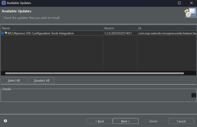

Hello @danielkrol
I'd like to share an update on this issue. I got a method from the MCUXpresso Config tool team, as shown below.
Please update Config Tools inside MCUXpresso IDE 24.12 to Config Tools 25.03:
  1. In MCUXpresso IDE, go to Help > Install New Software > Manage and enable the MCUXpresso Config Tools Update Site
2. Click Apply and Close and go to Help > Check for Updates. A new version of Config Tools will be available for installation. Finish the update using the update wizard.
Thank you.
Alice
