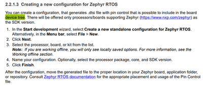

Regarding the Zephyr device tree, I'm pretty sure I saw something about Config Tools providing Device Tree configs. As I recall there was a Zephyr mode for that version of CT. Is there another version of CT that provides this information?
1,170 Views
EdwinHz
Hi @ClarkS,
I found the following on the "User Guide for MCUXpresso Config Tools (Desktop)" (GSMCUXCTUG

I just thought of another question. I want to eventually convert this project to be a Zephyr project. Isn't there some way to have Config Tools provide the device tree configuration? I'm pretty sure I've seen it somewhere in CT, but I can't find it now.
