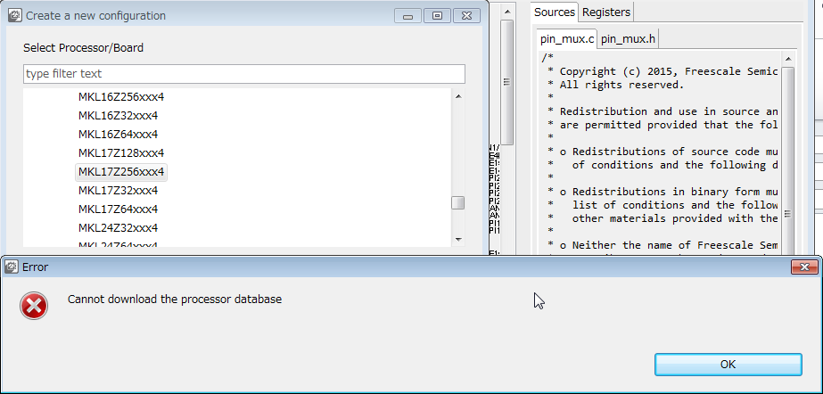

isaotakashima
Dear Libor Ukropec,
Thank you for your reply.
Our company's IT division engineer modified some settings of proxy server and firewall, then I can see board and device list.
But I cannot download the processor database. See below error message.
Please advise to solve this issue as soon as possible.
Takashima
5,688 Views
liborukropec
Dear Takashima,
hard to say without knowin your network and proxy configuration. Please take a look to the LOG files located here:
c:\Users\<your-user-name>\.nxp\swtools.log + c:\Users\<your-user-name>\.nxp\nxp_conf_workspace\.metadata\.log and post it here so I can look if there's any evident problem or not (if the logs are big, please zip them).
Libor

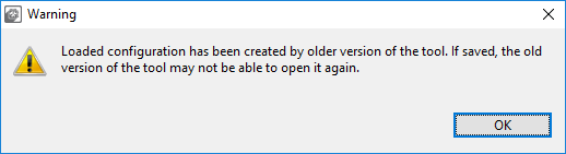

legbam5
I have the same problem. To build a new configuration doesn't work. How can I set the IP-address from above? To load  a configuration from a college I get the Message that Version 1 files are not supported.
5,686 Views
liborukropec
Hello Markus,
first few things to verify
1) are you behind a proxy in your work environment? If yes, does it require credentials?
2) from the log I can see you are using Pins tool version 2. Currently supported version is already v4. Is there a specific reason why you stick with older version?
3) "Version 1 files are not supported" I can see just warning message that if you save it with newer tool, it might not work in older tool (tools should be backward compatible, not forward compatible)
Back to the proxy, if you have http proxy which does not require name and password, you can specify it in this file
c:\nxp\i.MX_Pins_v2\bin\tools.ini
fragment of tools.ini (probably the java.net.useSystemProxies should be set to false)
-Djava.net.useSystemProxies=true
-Dhttp.proxyHost=somecompany.proxy.net
-Dhttp.proxyPort=80‍‍‍
More details about specifying the proxy can be found on Oracle web site: Networking Properties
And as a last resort if you provide the board/processor you would like to use I can prepare offline ZIP archive which you can download and manually extract into proper directory.
Libor
5,267 Views
SebastianGallwas
for me this was not working, but it was a good hint.
I added these two additional lines:
-Dhttps.proxyHost=<server address>
-Dhttps.proxyPort=<server port>
hope this helps someone in the future.
regards
Sebastian
