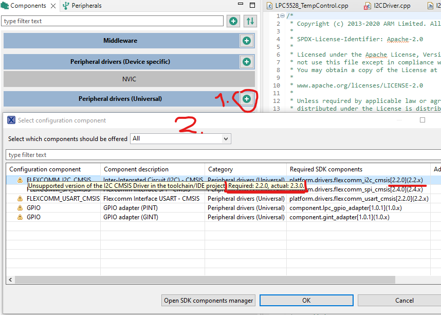

using Peripheral Tools, I just wanted to add an "universal i2c driver" (i.e., CMSIS based driver) to my project:
However, in the window where I get to "Select configuration component", I see a warning a FLEXCOM_I2C_CMSIS:
"Unsupported version of the I2C CMSIS Driver in the toolchain/IDE project. Required:2.2.0, actual 2.3.0"
Why is this and how do I resolve this issue?

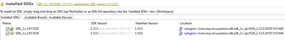

Installed SDKs:

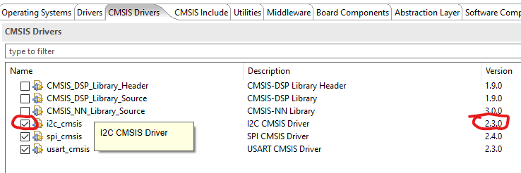

Theses are CMSIS SDK components in my project:
Running MCUXpresso IDE V11.6.1.

Unfortunately, the support of the newest SDK driver is yet in progress. The warning will be fixed along with next release of the config tools. For now, as a workaround, it should be fine to ignore the warning.

Hello @danielholala,
Unsupported version happens because SDK has a different version than the one Config Tools expects; nevertheless, for this case, it should not be a problem to proceed with your configuration.
Could you please add the FLEXCOMM_I2C_CMSIS driver and try to configure it out?
Best regards, Raul.

Ignoring the warning seems ok.
I'm now also trying to add the FLEXCOMM_USART_CMSIS driver via Peripheral Tools to my project.
Here, the same warning ("unsupported version ...") appears:
Like the last warning, this happens because the ConfigTools is expecting a different version than the SDK has; but the warning should not be a problem to stop your configuration.
Being that said, older SDKs should meet the version ConfigTools is asking for. SDK v9.0 for example, has the required: 2.2.0.
The recommendation is to go ahead with your configuration; but if your goal is to eliminate the warnings, you could try with older versions of the SDKs like v9.0 to meet the ConfigTools.
