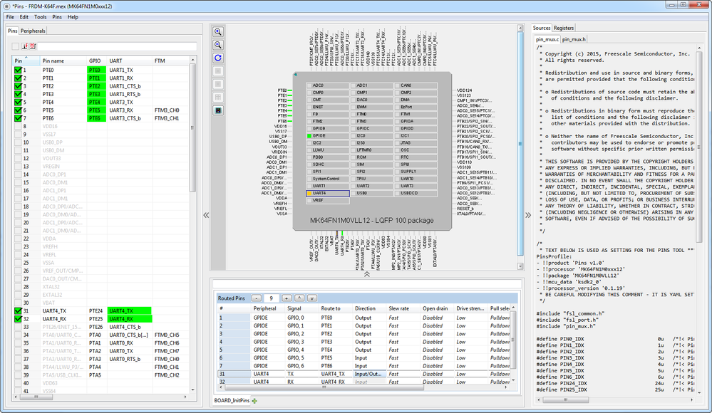

The new NXP Pins tool which has been showcased at FTF 2016 in Austin is now available as Web and Desktop application.
The Kinetis Expert Pins Tool makes configuring, muxing and routing of pins very easy and fast. It provides real-time feedback of conflicts and provides an intuitive graphical interface with several views. The tool generates Kinetis SDK V2.0 compatible sources files which can be directly integrated into C/C++ applications.
The Pins tool is available both as Web application (no installation needed) and as a Desktop application for Linux, Mac and Windows.

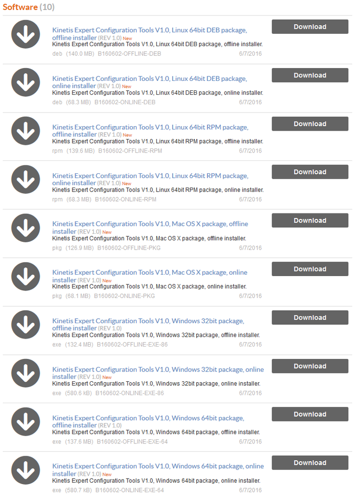

There are two different installer types:
  1. 'offline' is a 130 MByte download. This method is recommended for slower internet connections or for installation on multiple machines.
  2. 'online' is a small 500 KByte download, all the other installation data will be loaded from the internet during installation.
Mac OS X and Linux installers are 64bit. For Windows there are both 32bit and 64bit installers available.

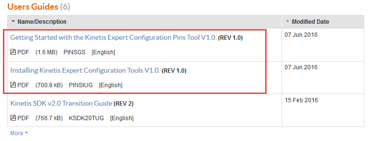

Documenation is availble on Software Development Kit for Kinetis MCUs|NXP in the documenation download section, as well attached to this article (Getting Started is available in Chinese):

When I click to download I get a pop-up with the screen showing the ten items I could download but clicking on them has no effect. I double checked and I am logged in yet with the latest version of Google I can't download! I tried Microsofts Edge with the same results but it failed when I tried to edit this post... bad edge..
Hi Kevin,
Be aware that there is the V2 of the tools available now, see Kinetis Expert System Configuration Tools V2 with Clocks Tool now available!
I quickly checked the downloads (I'm using FireFox), and that worked fine for me.
Can you try again? I have seen reports that using Internet Explorer or Edge can cause issues or even corrupt the downloaded files.
I hope this helps,
Erich
