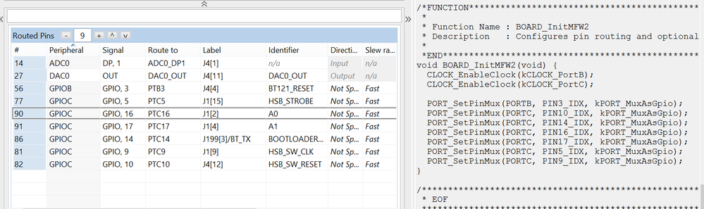

Kinetis Expert Version 2.0, PC version, starting with Freedom K64F board configuration.
I enabled peripheral DAC0 and ADC0 and routed a couple pins.
The pin initialization for these pins is missing from the generated code.
What's going on? Should we not use this tool?
Best Regards, Dave
PS: These are the default mux connections, but I expected initialization so I can use alternate configurations...

Hello Dave,
I have analyzed your issue but these analog pins (e.g. ADC0_DP1) cannot be routed to another devices, i.e. there are not any mux control bitfields (Pin Control Registers) for these pins. Please, see the K64P144M120SF5RM reference manual for details.
Therefore the Pins tool does not generate any code for routing of these pins.

davenadler
Senior Contributor I
Got it, Thanks!
