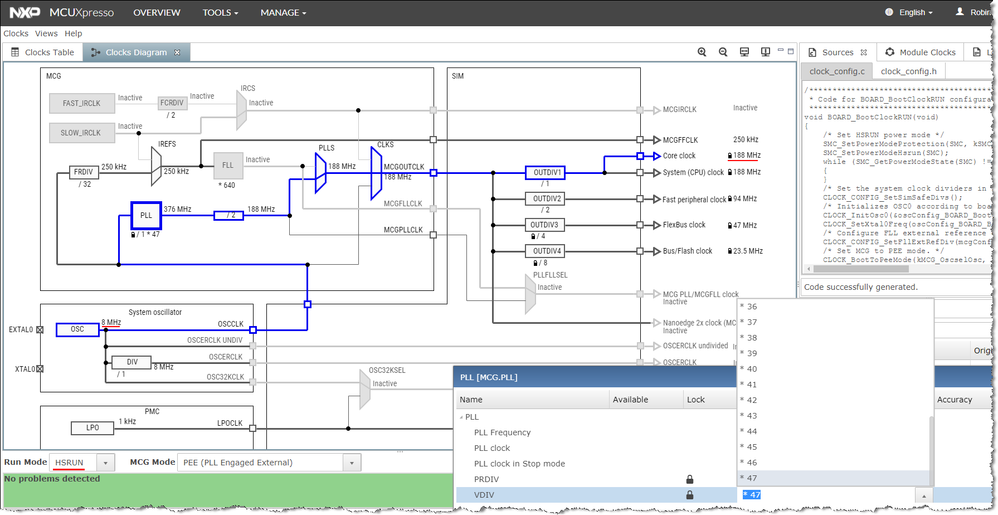

 I need urgently the clock_config.c and clock_config.h for the MKV58 in the SDK 2.0. My custom board uses a 8 MHZ external crystal and I want to configure the clocks for the maximum possible with a 8 MHZ crystal and for the MKV58.
I could not figure out how to use the clock config tools for it.

Hi Ari Mendes,
When you select 'HSRUN' mode with 8MHz crystal, this maybe the maximum possible:

Hi Ari,
  • go to mcuxpresso.nxp.com
  • create new configuration for MKV58
  • from main menu select TOOLS - Clocks Tool
  • configure your clocks as you need, e.g. set external oscilator to 8MHz and configure PLL
  • use "Clock Diagram" to review your configuration
  • if there are no problems, copy-paste clock_config.c from "Sources" tab into your application
Note: It is also possible to download Clock tool to your local computer and use it offline.
Marek
