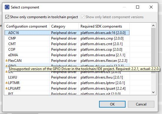

Hello all,
I'm very new to using MCUXpresso IDE & Config Tools so my apologies in advance if this is a novice question.  I'm trying to explore adding a peripheral support to a FRDM-KW36 project using MCUXpresso IDE Config Tools Peripherals GUI.  I'm trying to start with something simple (seemingly) like an interrupt handler for a GPIO.  When I go to the Peripherals view and Components pane and click on the plus icon next to the "Peripheral drivers" label I get the following error on the tooltip:
Furthermore, if I ignore it and just click OK, I get a "Problem Occurred" window popup saying " 'UI refresh' has encountered a problem.  An internal error has occurred."  Expected I guess as it warned me about the incompatibility.
My question is, how do I update the driver versions?  It says I need 2.2.1 and I have 2.2.0 for GPIO.  My understanding is that this is tied to my SDK.  I recently downloaded the standard FRDM-KW36 SDK from NXP's website, so I don't understand why it would be incompatible.  In any case, what is the best way to go about updating the drivers where I'm getting those warning icons?
Thank you in advance for your assistance.
Nick

Hi Nick,
attached please find hotfix with updated KW35 and KW36 data resolving the "UI refresh" error in MCUXpresso Config Tools v6 and MCUXpresso IDE v11.0:
In MCUXpresso IDE v11 you can install it using ConfigTools > Data Manager > Import and in MCUXpresso Config Tools v6 using File > Data Manager > Import. In the import, select the attached hotfix file and desired processors.
Regarding the warning about unsupported driver version, as you mentioned, this is tied to SDK version. The KW35 and KW36 processors are supported by SDK v2.2.0 which is unfortunately not fully supported by Peripherals tool. Specifically, some of the driver versions in SDK v2.2.0 are not fully supported by Peripherals tool components, in case of KW35/KW36 it's following drivers:
FlexCAN: required is 2.2.3 vs 2.2.0 in SDK
GPIO: required 2.2.1 vs. 2.2.0 in SDK
I2C: required 2.0.5 vs. 2.0.3 in SDK
LPTMR: required 2.0.1 vs. 2.0.0 in SDK
LPUART: required 2.2.4 vs. 2.2.3 in SDK
The differences between required and actual driver may not be significant and probably will have no impact on Peripherals tool functionality so you can use it, however, be aware that the combination was not tested.
Lukas

nsunshine
Lukas,
Thank you.  I can confirm the UI error goes away.  I will have to take some further time with the Peripherals tool to ensure things are working correctly, but so far it looks good.
Nick

nsunshine
Thank you for the reply.  Yes, I am using MCUXpresso version 11.0.0.  I will try working with an earlier version and see if I have any success.
Edit 1:  I tried version 10.3.1 and unfortunately it says that the processor (MKW36Z512VHT4) is not supported with the Peripherals tool
