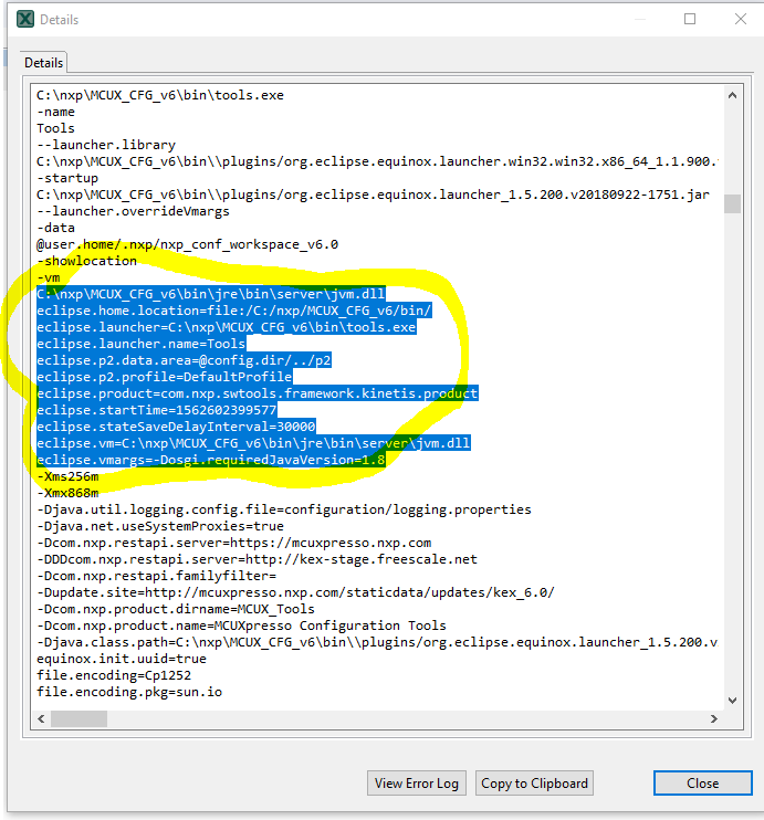

Installed V6 of MCU Config tool and tried to open an existing MEX file. Got Communications Error. Check your internet connection and try again.
My internet is ok.  I heard this error may be related to an unsupported mcu, but we're using K65.
It may be that this mex was created with a V5 Mcu config tool.
LArry

I'll put V6 back later, but below is the data for V5.  You install your own Java with the tool install and provide the path to it?
I have a newer Java for Eclipse but I don't see it on the path, so I don't think you'd pick it up over yours.

Hello Larry,
yes, MEX from v5 should work in v6 (not always vice versa). In order to help, could you please share the log file from directory location I wrote in previous post? Otherwise I do not know how to help.
Also you can paste what exact processor it is, to double check it is supported by the latest V6? MK65FN2M0xxx18 or MK65FX1M0xxx18? If am I correct both are supported by V5 and V6.

This may be the last V6 log - the time looks right...
Jul 05, 2019 12:01:59 PM com.nxp.swtools.kex.api.internal.MfactApiClient listProcessors
SEVERE: [NETWORK] listProcessors - server not available or other error
javax.net.ssl.SSLHandshakeException: sun.security.validator.ValidatorException: PKIX path building failed: sun.security.provider.certpath.SunCertPathBuilderException: unable to find valid certification path to requested target

3,696 Views
larry_ciummo
Added V6 back to my system. Ran as it and confirmed still gets “communications error”.
Changed the tool.ini rest api server to not use https. Tool downloaded required components and started ok.
Here’s the about details… Looks like your Java.
To me this looks like some sort of cert trust validation failure.
      • Date: Tuesday, July 9, 2019 at 10:49:31 AM Eastern Daylight Time

      • Platform Details:
      • System properties:
applicationXMI=org.eclipse.ui.workbench/LegacyIDE.e4xmi
awt.toolkit=sun.awt.windows.WToolkit
com.nxp.product.dirname=MCUX_Tools
com.nxp.product.name=MCUXpresso Configuration Tools
com.nxp.restapi.familyfilter=
com.nxp.restapi.server=http://mcuxpresso.nxp.com
ds.delayed.keepInstances=true
ds.delayed.keepInstances.default=true
eclipse.application=com.nxp.swtools.framework.application
eclipse.commands=-os
win32
-ws
win32
-arch
x86_64
-showsplash
-launcher
C:\nxp\MCUX_CFG_v6\bin\tools.exe
-name
Tools
--launcher.library
plugins/org.eclipse.equinox.launcher.win32.win32.x86_64_1.1.900.v20180922-1751\eclipse_1801.dll
-startup
plugins/org.eclipse.equinox.launcher_1.5.200.v20180922-1751.jar
--launcher.overrideVmargs
-data
@user.home/.nxp/nxp_conf_workspace_v6.0
-showlocation
-vm
C:\nxp\MCUX_CFG_v6\bin\jre\bin\server\jvm.dll
eclipse.home.location=file:/C:/nxp/MCUX_CFG_v6/bin/
eclipse.launcher=C:\nxp\MCUX_CFG_v6\bin\tools.exe
eclipse.launcher.name=Tools
eclipse.p2.data.area=@config.dir/../p2
eclipse.p2.profile=DefaultProfile
eclipse.product=com.nxp.swtools.framework.kinetis.product
eclipse.startTime=1562683670301
eclipse.stateSaveDelayInterval=30000
eclipse.vm=C:\nxp\MCUX_CFG_v6\bin\jre\bin\server\jvm.dll
eclipse.vmargs=-Dosgi.requiredJavaVersion=1.8
-Xms256m
-Xmx868m
-Djava.util.logging.config.file=configuration/logging.properties
-Djava.net.useSystemProxies=true
-Dcom.nxp.restapi.server=http://mcuxpresso.nxp.com
-Dcom.nxp.restapi.familyfilter=
-Dupdate.site=http://mcuxpresso.nxp.com/staticdata/updates/kex_6.0/
-Dcom.nxp.product.dirname=MCUX_Tools
-Dcom.nxp.product.name=MCUXpresso Configuration Tools
-Djava.class.path=C:\nxp\MCUX_CFG_v6\bin
equinox.init.uuid=true
file.encoding=Cp1252
file.encoding.pkg=sun.io
file.separator=\
gosh.args=--nointeractive
java.awt.graphicsenv=sun.awt.Win32GraphicsEnvironment
java.awt.printerjob=sun.awt.windows.WPrinterJob
java.class.version=52.0
java.endorsed.dirs=C:\nxp\MCUX_CFG_v6\bin\jre\lib\endorsed
java.ext.dirs=C:\nxp\MCUX_CFG_v6\bin\jre\lib\ext;C:\WINDOWS\Sun\Java\lib\ext
java.home=C:\nxp\MCUX_CFG_v6\bin\jre
java.io.tmpdir=C:\Users\lciummo\AppData\Local\Temp\
java.library.path=C:\nxp\MCUX_CFG_v6\bin;C:\WINDOWS\Sun\Java\bin;C:\WINDOWS\system32;C:\WINDOWS;C:/nxp/MCUX_CFG_v6/bin/jre/bin/server;C:/nxp/MCUX_CFG_v6/bin/jre/bin;C:/nxp/MCUX_CFG_v6/bin/jre/lib/amd64;C:\WINDOWS\system32;C:\WINDOWS;C:\WINDOWS\System32\Wbem;C:\WINDOWS\System32\WindowsPowerShell\v1.0\;C:\WINDOWS\System32\OpenSSH\;C:\Program Files\SafeNet\Authentication\SAC\x64;C:\Program Files\SafeNet\Authentication\SAC\x32;C:\Program Files (x86)\CheckPoint\Endpoint Security\Endpoint Common\bin;C:\Program Files\Perforce\;C:\Program Files\PuTTY\;C:\Program Files\Git\cmd;C:\Program Files\Git\mingw64\bin;C:\Program Files\Git\usr\bin;C:\Users\lciummo\AppData\Local\Microsoft\WindowsApps;;C:\nxp\MCUX_CFG_v6\bin;;.
java.runtime.name=Java(TM) SE Runtime Environment
java.runtime.version=1.8.0_201-b09
java.specification.name=Java Platform API Specification
java.specification.vendor=Oracle Corporation
java.specification.version=1.8
java.vendor=Oracle Corporation
java.vendor.url=http://java.oracle.com/
java.vendor.url.bug=http://bugreport.sun.com/bugreport/
java.version=1.8.0_201
java.vm.info=mixed mode
java.vm.name=Java HotSpot(TM) 64-Bit Server VM
java.vm.specification.name=Java Virtual Machine Specification
java.vm.specification.vendor=Oracle Corporation
java.vm.specification.version=1.8
java.vm.vendor=Oracle Corporation
java.vm.version=25.201-b09
line.separator=
org.eclipse.equinox.launcher.splash.location=c:\nxp\MCUX_CFG_v6\bin\configuration\org.eclipse.equinox.launcher\com.nxp.swtools.framework.kinetis_6.0.0.201905210938\splash.bmp
org.eclipse.swt.internal.deviceZoom=100
org.osgi.framework.executionenvironment=OSGi/Minimum-1.0,OSGi/Minimum-1.1,OSGi/Minimum-1.2,JavaSE/compact1-1.8,JavaSE/compact2-1.8,JavaSE/compact3-1.8,JRE-1.1,J2SE-1.2,J2SE-1.3,J2SE-1.4,J2SE-1.5,JavaSE-1.6,JavaSE-1.7,JavaSE-1.8
org.osgi.framework.language=en
org.osgi.framework.os.name=Windows10
org.osgi.framework.os.version=10.0.0
org.osgi.framework.processor=x86-64
org.osgi.framework.storage=C:\nxp\MCUX_CFG_v6\bin\configuration
org.osgi.framework.system.capabilities=osgi.ee; osgi.ee="OSGi/Minimum"; version:List="1.8"
org.osgi.framework.system.packages=java.applet,java.awt,java.awt.color,java.awt.datatransfer,java.awt.dnd,java.awt.event,java.awt.font,java.awt.geom,java.awt.im,java.awt.im.spi,java.awt.image,java.awt.image.renderable,java.awt.print,java.beans,java.beans.beancontext,java.io,java.lang,java.lang.annotation,java.lang.instrument,java.lang.invoke,java.lang.management,java.lang.ref,java.lang.reflect,java.math,java.net,java.nio,java.nio.channels,java.nio.channels.spi,java.nio.charset,java.nio.charset.spi,java.nio.file,java.nio.file.attribute,java.nio.file.spi,java.rmi,java.rmi.activation,java.rmi.dgc,java.rmi.registry,java.rmi.server,java.security,java.security.acl,java.security.cert,java.security.interfaces,java.security.spec,java.sql,java.text,java.text.spi,java.time,java.time.chrono,java.time.format,java.time.temporal,java.time.zone,java.util,java.util.concurrent,java.util.concurrent.atomic,java.util.concurrent.locks,java.util.function,java.util.jar,java.util.logging,java.util.prefs,java.util.regex,java.util.spi,java.util.stream,java.util.zip,javax.accessibility,javax.activation,javax.activity,javax.annotation,javax.annotation.processing,javax.crypto,javax.crypto.interfaces,javax.crypto.spec,javax.imageio,javax.imageio.event,javax.imageio.metadata,javax.imageio.plugins.bmp,javax.imageio.plugins.jpeg,javax.imageio.spi,javax.imageio.stream,javax.jws,javax.jws.soap,javax.lang.model,javax.lang.model.element,javax.lang.model.type,javax.lang.model.util,javax.management,javax.management.loading,javax.management.modelmbean,javax.management.monitor,javax.management.openmbean,javax.management.relation,javax.management.remote,javax.management.remote.rmi,javax.management.timer,javax.naming,javax.naming.directory,javax.naming.event,javax.naming.ldap,javax.naming.spi,javax.net,javax.net.ssl,javax.print,javax.print.attribute,javax.print.attribute.standard,javax.print.event,javax.rmi,javax.rmi.CORBA,javax.rmi.ssl,javax.script,javax.security.auth,javax.security.auth.callback,javax.security.auth.kerberos,javax.security.auth.login,javax.security.auth.spi,javax.security.auth.x500,javax.security.cert,javax.security.sasl,javax.sound.midi,javax.sound.midi.spi,javax.sound.sampled,javax.sound.sampled.spi,javax.sql,javax.sql.rowset,javax.sql.rowset.serial,javax.sql.rowset.spi,javax.swing,javax.swing.border,javax.swing.colorchooser,javax.swing.event,javax.swing.filechooser,javax.swing.plaf,javax.swing.plaf.basic,javax.swing.plaf.metal,javax.swing.plaf.multi,javax.swing.plaf.nimbus,javax.swing.plaf.synth,javax.swing.table,javax.swing.text,javax.swing.text.html,javax.swing.text.html.parser,javax.swing.text.rtf,javax.swing.tree,javax.swing.undo,javax.tools,javax.transaction,javax.transaction.xa,javax.xml,javax.xml.bind,javax.xml.bind.annotation,javax.xml.bind.annotation.adapters,javax.xml.bind.attachment,javax.xml.bind.helpers,javax.xml.bind.util,javax.xml.crypto,javax.xml.crypto.dom,javax.xml.crypto.dsig,javax.xml.crypto.dsig.dom,javax.xml.crypto.dsig.keyinfo,javax.xml.crypto.dsig.spec,javax.xml.datatype,javax.xml.namespace,javax.xml.parsers,javax.xml.soap,javax.xml.stream,javax.xml.stream.events,javax.xml.stream.util,javax.xml.transform,javax.xml.transform.dom,javax.xml.transform.sax,javax.xml.transform.stax,javax.xml.transform.stream,javax.xml.validation,javax.xml.ws,javax.xml.ws.handler,javax.xml.ws.handler.soap,javax.xml.ws.http,javax.xml.ws.soap,javax.xml.ws.spi,javax.xml.ws.spi.http,javax.xml.ws.wsaddressing,javax.xml.xpath,org.ietf.jgss,org.omg.CORBA,org.omg.CORBA_2_3,org.omg.CORBA_2_3.portable,org.omg.CORBA.DynAnyPackage,org.omg.CORBA.ORBPackage,org.omg.CORBA.portable,org.omg.CORBA.TypeCodePackage,org.omg.CosNaming,org.omg.CosNaming.NamingContextExtPackage,org.omg.CosNaming.NamingContextPackage,org.omg.Dynamic,org.omg.DynamicAny,org.omg.DynamicAny.DynAnyFactoryPackage,org.omg.DynamicAny.DynAnyPackage,org.omg.IOP,org.omg.IOP.CodecFactoryPackage,org.omg.IOP.CodecPackage,org.omg.Messaging,org.omg.PortableInterceptor,org.omg.PortableInterceptor.ORBInitInfoPackage,org.omg.PortableServer,org.omg.PortableServer.CurrentPackage,org.omg.PortableServer.POAManagerPackage,org.omg.PortableServer.POAPackage,org.omg.PortableServer.portable,org.omg.PortableServer.ServantLocatorPackage,org.omg.SendingContext,org.omg.stub.java.rmi,org.w3c.dom,org.w3c.dom.bootstrap,org.w3c.dom.css,org.w3c.dom.events,org.w3c.dom.html,org.w3c.dom.ls,org.w3c.dom.ranges,org.w3c.dom.stylesheets,org.w3c.dom.traversal,org.w3c.dom.views,org.w3c.dom.xpath,org.xml.sax,org.xml.sax.ext,org.xml.sax.helpers
org.osgi.framework.uuid=59052962-dba7-433f-b3e2-6a7cf0feffeb
org.osgi.framework.vendor=Eclipse
org.osgi.framework.version=1.9.0
org.osgi.supports.framework.extension=true
org.osgi.supports.framework.fragment=true
org.osgi.supports.framework.requirebundle=true
os.arch=amd64
os.name=Windows 10
os.version=10.0
osgi.arch=x86_64
osgi.bundles=reference:file:org.eclipse.osgi.compatibility.state_1.1.300.v20181116-1550.jar,reference:file:org.eclipse.osgi.compatibility.state.nl_zh_4.10.0.v20190126060001.jar,reference:file:org.eclipse.osgi.nl_zh_4.10.0.v20190126060001.jar,reference:file:org.eclipse.osgi.services.nl_zh_4.10.0.v20190126060001.jar,reference:file:org.eclipse.osgi.util.nl_zh_4.10.0.v20190126060001.jar,reference:file:com.google.gson_2.8.2.v20180104-1110.jar@4,reference:file:com.google.guava_21.0.0.v20170206-1425.jar@4,reference:file:com.ibm.icu_63.1.0.v20181030-1705.jar@4,reference:file:com.nxp.kex.standalone_1.0.0.201905210938.jar@4,reference:file:com.nxp.swtools.clocks_5.0.0.201905210938.jar@4,reference:file:com.nxp.swtools.clocks.model_1.0.0.201905210938.jar@4,reference:file:com.nxp.swtools.clocks.swt_1.0.0.201905210938.jar@4,reference:file:com.nxp.swtools.common.ui.utils_1.4.0.201905210938.jar@4,reference:file:com.nxp.swtools.common.ui.utils.swt_1.2.0.201905210938.jar@4,reference:file:com.nxp.swtools.common.utils_1.1.1.201905210938.jar@4,reference:file:com.nxp.swtools.configuration_1.6.0.201905210938.jar@4,reference:file:com.nxp.swtools.core_1.10.0.201905210938.jar@4,reference:file:com.nxp.swtools.core.service_1.13.0.201905210938.jar@4,reference:file:com.nxp.swtools.dashboard_1.0.0.201905210938.jar@4,reference:file:com.nxp.swtools.databinding_1.4.0.201905210938.jar@4,reference:file:com.nxp.swtools.dcd.model_1.0.0.201905210938.jar@4,reference:file:com.nxp.swtools.dcdx_1.0.0.201905210938.jar@4,reference:file:com.nxp.swtools.dcdx.swt_1.0.0.201905210938.jar@4,reference:file:com.nxp.swtools.derivative_1.0.0.201905210938.jar@4,reference:file:com.nxp.swtools.derivative.rcp_1.0.0.201905210938.jar@4,reference:file:com.nxp.swtools.doc.kinetis_4.0.0.201905210938/@4,reference:file:com.nxp.swtools.docannotations_1.0.0.201905210938.jar@4,reference:file:com.nxp.swtools.expert_1.0.0.201905210938.jar@4,reference:file:com.nxp.swtools.framework_4.0.0.201905210938.jar@4,reference:file:com.nxp.swtools.framework.kinetis_6.0.0.201905210938.jar@4,reference:file:com.nxp.swtools.mux_5.0.0.201905210938.jar@4,reference:file:com.nxp.swtools.mux.swt_1.0.0.201905210938.jar@4,reference:file:com.nxp.swtools.periphs.controller_0.0.1.201905210938.jar@4,reference:file:com.nxp.swtools.periphs.gui_5.0.0.201905210938.jar@4,reference:file:com.nxp.swtools.periphs.gui.swt_0.0.1.201905210938.jar@4,reference:file:com.nxp.swtools.periphs.model_0.0.1.201905210938.jar@4,reference:file:com.nxp.swtools.projectcloner_2.0.0.201905210938.jar@4,reference:file:com.nxp.swtools.projectcloner.engine_2.0.0.201905210938.jar@4,reference:file:com.nxp.swtools.projectcloner.rcp_1.0.0.201905210938.jar@4,reference:file:com.nxp.swtools.rcp_1.0.0.201905210938.jar@4,reference:file:com.nxp.swtools.rcp.analytics_1.0.0.201905210938.jar@4,reference:file:com.nxp.swtools.sdkmanifest_1.0.0.201905210938.jar@4,reference:file:com.nxp.swtools.sdkproject_1.0.0.201905210938.jar@4,reference:file:com.nxp.swtools.sharedconfiguration_1.1.0.201905210938.jar@4,reference:file:com.nxp.swtools.tee.controller_0.0.1.201905210938.jar@4,reference:file:com.nxp.swtools.tee.gui_0.0.1.201905210938.jar@4,reference:file:com.nxp.swtools.tee.model_0.0.1.201905210938.jar@4,reference:file:com.nxp.swtools.tutorial_1.0.0.201905210938.jar@4,reference:file:com.nxp.swtools.ui.inspector_1.10.0.201905210938.jar@4,reference:file:com.nxp.swtools.ui.inspector.graphical_1.3.0.201905210938.jar@4,reference:file:com.nxp.swtools.ui.targetcpu_1.6.0.201905210938.jar@4,reference:file:com.nxp.swtools.ui.views_1.0.0.201905210938.jar@4,reference:file:com.nxp.swtools.utils_1.0.0.201905210938.jar@4,reference:file:com.nxp.swtools.utils.support.markdown_1.0.0.201905210938.jar@4,reference:file:com.nxp.swtools.utils.swt_1.0.0.201905210938.jar@4,reference:file:com.nxp.swtools.validation_1.1.0.201905210938.jar@4,reference:file:com.sun.el_2.2.0.v201303151357.jar@4,reference:file:javax.activation_1.1.0.v201211130549.jar@4,reference:file:javax.annotation_1.2.0.v201602091430.jar@4,reference:file:javax.el_2.2.0.v201303151357.jar@4,reference:file:javax.inject_1.0.0.v20091030.jar@4,reference:file:javax.servlet_3.1.0.v201410161800.jar@4,reference:file:javax.servlet.jsp_2.2.0.v201112011158.jar@4,reference:file:javax.xml_1.3.4.v201005080400.jar@4,reference:file:javax.xml.bind_2.2.0.v201105210648.jar@4,reference:file:org.apache.batik.constants_1.10.0.v20180703-1553.jar@4,reference:file:org.apache.batik.css_1.10.0.v20180703-1553.jar@4,reference:file:org.apache.batik.i18n_1.10.0.v20180703-1553.jar@4,reference:file:org.apache.batik.util_1.10.0.v20180703-1553.jar@4,reference:file:org.apache.commons.codec_1.10.0.v20180409-1845.jar@4,reference:file:org.apache.commons.io_2.2.0.v201405211200.jar@4,reference:file:org.apache.commons.jxpath_1.3.0.v200911051830.jar@4,reference:file:org.apache.commons.logging_1.2.0.v20180409-1502.jar@4,reference:file:org.apache.felix.gogo.command_1.0.2.v20170914-1324.jar@4,reference:file:org.apache.felix.gogo.runtime_1.1.0.v20180713-1646.jar@4,reference:file:org.apache.felix.gogo.shell_1.1.0.v20180713-1646.jar@4,reference:file:org.apache.felix.scr_2.0.14.v20180822-1822.jar@1:start,reference:file:org.apache.httpcomponents.httpclient_4.5.5.v20180409-1525.jar@4,reference:file:org.apache.httpcomponents.httpcore_4.4.9.v20180409-1525.jar@4,reference:file:org.apache.jasper.glassfish_2.2.2.v201501141630.jar@4,reference:file:org.apache.lucene.analyzers-common_7.5.0.v20181003-1532.jar@4,reference:file:org.apache.lucene.analyzers-smartcn_7.5.0.v20181003-1532.jar@4,reference:file:org.apache.lucene.core_7.5.0.v20181003-1532.jar@4,reference:file:org.apache.xmlgraphics_2.2.0.v20180809-1640.jar@4,reference:file:org.eclipse.cdt.core_6.6.0.201812101042.jar@4,reference:file:org.eclipse.cdt.core.native_5.10.1.201811241055.jar@4,reference:file:org.eclipse.cdt.ui_6.4.0.201811241855.jar@4,reference:file:org.eclipse.compare_3.7.400.v20181109-1335.jar@4,reference:file:org.eclipse.compare.core_3.6.300.v20180827-1041.jar@4,reference:file:org.eclipse.compare.core.nl_zh_4.10.0.v20190126060001.jar@4,reference:file:org.eclipse.compare.nl_zh_4.10.0.v20190126060001.jar@4,reference:file:org.eclipse.compare.win32_1.2.300.v20180926-0905.jar@4,reference:file:org.eclipse.compare.win32.nl_zh_4.10.0.v20190126060001.jar@4,reference:file:org.eclipse.core.commands_3.9.200.v20180827-1727.jar@4,reference:file:org.eclipse.core.commands.nl_zh_4.10.0.v20190126060001.jar@4,reference:file:org.eclipse.core.contenttype_3.7.200.v20181107-1343.jar@4,reference:file:org.eclipse.core.contenttype.nl_zh_4.10.0.v20190126060001.jar@4,reference:file:org.eclipse.core.databinding_1.7.100.v20181030-1443.jar@4,reference:file:org.eclipse.core.databinding.beans_1.4.300.v20181030-1443.jar@4,reference:file:org.eclipse.core.databinding.beans.nl_zh_4.10.0.v20190126060001.jar@4,reference:file:org.eclipse.core.databinding.nl_zh_4.10.0.v20190126060001.jar@4,reference:file:org.eclipse.core.databinding.observable_1.6.300.v20180827-2028.jar@4,reference:file:org.eclipse.core.databinding.observable.nl_zh_4.10.0.v20190126060001.jar@4,reference:file:org.eclipse.core.databinding.property_1.6.300.v20180827-2028.jar@4,reference:file:org.eclipse.core.databinding.property.nl_zh_4.10.0.v20190126060001.jar@4,reference:file:org.eclipse.core.expressions_3.6.200.v20180817-1401.jar@4,reference:file:org.eclipse.core.expressions.nl_zh_4.10.0.v20190126060001.jar@4,reference:file:org.eclipse.core.filebuffers_3.6.400.v20181028-0633.jar@4,reference:file:org.eclipse.core.filebuffers.nl_zh_4.10.0.v20190126060001.jar@4,reference:file:org.eclipse.core.filesystem_1.7.200.v20180828-0158.jar@4,reference:file:org.eclipse.core.filesystem.nl_zh_4.10.0.v20190126060001.jar@4,reference:file:org.eclipse.core.filesystem.win32.x86_64_1.4.100.v20180828-0158.jar@4,reference:file:org.eclipse.core.filesystem.win32.x86_64.nl_zh_4.10.0.v20190126060001.jar@4,reference:file:org.eclipse.core.jobs_3.10.200.v20180912-1356.jar@4,reference:file:org.eclipse.core.jobs.nl_zh_4.10.0.v20190126060001.jar@4,reference:file:org.eclipse.core.net_1.3.400.v20181030-1645.jar@4,reference:file:org.eclipse.core.net.nl_zh_4.10.0.v20190126060001.jar@4,reference:file:org.eclipse.core.net.win32.x86_64_1.1.300.v20181126-0635.jar@4,reference:file:org.eclipse.core.net.win32.x86_64.nl_zh_4.10.0.v20190126060001.jar@4,reference:file:org.eclipse.core.resources_3.13.200.v20181121-1020.jar@4,reference:file:org.eclipse.core.resources.nl_zh_4.10.0.v20190126060001.jar@4,reference:file:org.eclipse.core.resources.win32.x86_64_3.5.300.v20181030-1942.jar@4,reference:file:org.eclipse.core.resources.win32.x86_64.nl_zh_4.10.0.v20190126060001.jar@4,reference:file:org.eclipse.core.runtime_3.15.100.v20181107-1343.jar@4:start,reference:file:org.eclipse.core.runtime.nl_zh_4.10.0.v20190126060001.jar@4,reference:file:org.eclipse.core.variables_3.4.300.v20181028-0627.jar@4,reference:file:org.eclipse.core.variables.nl_zh_4.10.0.v20190126060001.jar@4,reference:file:org.eclipse.debug.core_3.13.100.v20181201-1650.jar@4,reference:file:org.eclipse.debug.core.nl_zh_4.10.0.v20190126060001.jar@4,reference:file:org.eclipse.e4.core.commands_0.12.400.v20181119-1026.jar@4,reference:file:org.eclipse.e4.core.contexts_1.7.100.v20180817-1215.jar@4,reference:file:org.eclipse.e4.core.contexts.nl_zh_4.10.0.v20190126060001.jar@4,reference:file:org.eclipse.e4.core.di_1.7.100.v20180817-1215.jar@4,reference:file:org.eclipse.e4.core.di.annotations_1.6.200.v20180817-1215.jar@4,reference:file:org.eclipse.e4.core.di.annotations.nl_zh_4.10.0.v20190126060001.jar@4,reference:file:org.eclipse.e4.core.di.extensions_0.15.200.v20180817-1215.jar@4,reference:file:org.eclipse.e4.core.di.extensions.nl_zh_4.10.0.v20190126060001.jar@4,reference:file:org.eclipse.e4.core.di.extensions.supplier_0.15.200.v20180817-1215.jar@4,reference:file:org.eclipse.e4.core.di.extensions.supplier.nl_zh_4.10.0.v20190126060001.jar@4,reference:file:org.eclipse.e4.core.di.nl_zh_4.10.0.v20190126060001.jar@4,reference:file:org.eclipse.e4.core.services_2.1.300.v20180930-0910.jar@4,reference:file:org.eclipse.e4.core.services.nl_zh_4.10.0.v20190126060001.jar@4,reference:file:org.eclipse.e4.emf.xpath_0.2.200.v20180828-0227.jar@4,reference:file:org.eclipse.e4.emf.xpath.nl_zh_4.10.0.v20190126060001.jar@4,reference:file:org.eclipse.e4.ui.bindings_0.12.300.v20180913-1535.jar@4,reference:file:org.eclipse.e4.ui.css.core_0.12.400.v20180917-1628.jar@4,reference:file:org.eclipse.e4.ui.css.core.nl_zh_4.10.0.v20190126060001.jar@4,reference:file:org.eclipse.e4.ui.css.swt_0.13.300.v20181030-1443.jar@4,reference:file:org.eclipse.e4.ui.css.swt.nl_zh_4.10.0.v20190126060001.jar@4,reference:file:org.eclipse.e4.ui.css.swt.theme_0.12.100.v20180828-0227.jar@4,reference:file:org.eclipse.e4.ui.css.swt.theme.nl_zh_4.10.0.v20190126060001.jar@4,reference:file:org.eclipse.e4.ui.di_1.2.400.v20180920-1522.jar@4,reference:file:org.eclipse.e4.ui.di.nl_zh_4.10.0.v20190126060001.jar@4,reference:file:org.eclipse.e4.ui.dialogs_1.1.300.v20180828-0227.jar@4,reference:file:org.eclipse.e4.ui.dialogs.nl_zh_4.10.0.v20190126060001.jar@4,reference:file:org.eclipse.e4.ui.model.workbench_2.1.200.v20180920-1522.jar@4,reference:file:org.eclipse.e4.ui.model.workbench.nl_zh_4.10.0.v20190126060001.jar@4,reference:file:org.eclipse.e4.ui.services_1.3.300.v20180920-1522.jar@4,reference:file:org.eclipse.e4.ui.services.nl_zh_4.10.0.v20190126060001.jar@4,reference:file:org.eclipse.e4.ui.widgets_1.2.300.v20180920-1522.jar@4,reference:file:org.eclipse.e4.ui.widgets.nl_zh_4.10.0.v20190126060001.jar@4,reference:file:org.eclipse.e4.ui.workbench_1.8.0.v20181119-1304.jar@4,reference:file:org.eclipse.e4.ui.workbench.addons.swt_1.3.300.v20181102-1042.jar@4,reference:file:org.eclipse.e4.ui.workbench.renderers.swt_0.14.400.v20181112-1716.jar@4,reference:file:org.eclipse.e4.ui.workbench.swt_0.14.400.v20181022-1348.jar@4,reference:file:org.eclipse.e4.ui.workbench3_0.14.200.v20180828-0227.jar@4,reference:file:org.eclipse.e4.ui.workbench3.nl_zh_4.10.0.v20190126060001.jar@4,reference:file:org.eclipse.ecf_3.9.3.v20181012-2016.jar@4,reference:file:org.eclipse.ecf.filetransfer_5.0.100.v20180301-0132.jar@4,reference:file:org.eclipse.ecf.identity_3.9.1.v20180810-0833.jar@4,reference:file:org.eclipse.ecf.provider.filetransfer_3.2.400.v20180306-0429.jar@4,reference:file:org.eclipse.ecf.provider.filetransfer.httpclient4_1.1.300.v20180301-0132.jar@4,reference:file:org.eclipse.ecf.provider.filetransfer.httpclient4.ssl_1.1.100.v20180301-0132.jar@4,reference:file:org.eclipse.ecf.provider.filetransfer.ssl_1.0.100.v20180301-0132.jar@4,reference:file:org.eclipse.ecf.ssl_1.2.100.v20180301-0132.jar@4,reference:file:org.eclipse.emf.common_2.15.0.v20180914-1817.jar@4,reference:file:org.eclipse.emf.ecore_2.16.0.v20181124-0637.jar@4,reference:file:org.eclipse.emf.ecore.change_2.13.0.v20180706-1146.jar@4,reference:file:org.eclipse.emf.ecore.xmi_2.15.0.v20180706-1146.jar@4,reference:file:org.eclipse.equinox.app_1.4.0.v20181009-1752.jar@4,reference:file:org.eclipse.equinox.bidi_1.1.200.v20180827-1235.jar@4,reference:file:org.eclipse.equinox.common_3.10.200.v20181021-1645.jar@2:start,reference:file:org.eclipse.equinox.concurrent_1.1.200.v20180827-1235.jar@4,reference:file:org.eclipse.equinox.console_1.3.200.v20181115-0906.jar@4,reference:file:org.eclipse.equinox.event_1.5.0.v20181008-1938.jar@2:start,reference:file:org.eclipse.equinox.frameworkadmin_2.1.100.v20180822-1258.jar@4,reference:file:org.eclipse.equinox.frameworkadmin.equinox_1.1.100.v20180822-1258.jar@4,reference:file:org.eclipse.equinox.frameworkadmin.equinox.nl_zh_4.10.0.v20190126060001.jar@4,reference:file:org.eclipse.equinox.frameworkadmin.nl_zh_4.10.0.v20190126060001.jar@4,reference:file:org.eclipse.equinox.http.jetty_3.6.200.v20181115-1346.jar@4,reference:file:org.eclipse.equinox.http.registry_1.1.600.v20180827-1235.jar@4,reference:file:org.eclipse.equinox.http.servlet_1.5.200.v20181008-1912.jar@4,reference:file:org.eclipse.equinox.jsp.jasper_1.1.100.v20180827-1235.jar@4,reference:file:org.eclipse.equinox.jsp.jasper.registry_1.1.100.v20180827-1235.jar@4,reference:file:org.eclipse.equinox.launcher_1.5.200.v20180922-1751.jar@4,reference:file:org.eclipse.equinox.launcher.nl_zh_4.10.0.v20190126060001.jar@4,reference:file:org.eclipse.equinox.launcher.win32.win32.x86_64_1.1.900.v20180922-1751/@4,reference:file:org.eclipse.equinox.launcher.win32.win32.x86_64.nl_zh_4.10.0.v20190126060001.jar@4,reference:file:org.eclipse.equinox.p2.artifact.repository_1.2.200.v20181119-1308.jar@4,reference:file:org.eclipse.equinox.p2.artifact.repository.nl_zh_4.10.0.v20190126060001.jar@4,reference:file:org.eclipse.equinox.p2.console_1.1.100.v20180822-1258.jar@4,reference:file:org.eclipse.equinox.p2.console.nl_zh_4.10.0.v20190126060001.jar@4,reference:file:org.eclipse.equinox.p2.core_2.5.100.v20180822-1532.jar@4,reference:file:org.eclipse.equinox.p2.core.nl_zh_4.10.0.v20190126060001.jar@4,reference:file:org.eclipse.equinox.p2.director_2.4.200.v20181102-0649.jar@4,reference:file:org.eclipse.equinox.p2.director.app_1.1.200.v20180822-1302.jar@4,reference:file:org.eclipse.equinox.p2.director.app.nl_zh_4.10.0.v20190126060001.jar@4,reference:file:org.eclipse.equinox.p2.director.nl_zh_4.10.0.v20190126060001.jar@4,reference:file:org.eclipse.equinox.p2.directorywatcher_1.2.100.v20180822-1302.jar@4,reference:file:org.eclipse.equinox.p2.directorywatcher.nl_zh_4.10.0.v20190126060001.jar@4,reference:file:org.eclipse.equinox.p2.engine_2.6.100.v20180822-1302.jar@4,reference:file:org.eclipse.equinox.p2.engine.nl_zh_4.10.0.v20190126060001.jar@4,reference:file:org.eclipse.equinox.p2.extensionlocation_1.3.100.v20180822-1302.jar@4,reference:file:org.eclipse.equinox.p2.extensionlocation.nl_zh_4.10.0.v20190126060001.jar@4,reference:file:org.eclipse.equinox.p2.garbagecollector_1.1.100.v20180822-1302.jar@4,reference:file:org.eclipse.equinox.p2.garbagecollector.nl_zh_4.10.0.v20190126060001.jar@4,reference:file:org.eclipse.equinox.p2.jarprocessor_1.1.200.v20180921-1009.jar@4,reference:file:org.eclipse.equinox.p2.jarprocessor.nl_zh_4.10.0.v20190126060001.jar@4,reference:file:org.eclipse.equinox.p2.metadata_2.4.200.v20181102-0649.jar@4,reference:file:org.eclipse.equinox.p2.metadata.nl_zh_4.10.0.v20190126060001.jar@4,reference:file:org.eclipse.equinox.p2.metadata.repository_1.3.100.v20180822-1302.jar@4,reference:file:org.eclipse.equinox.p2.metadata.repository.nl_zh_4.10.0.v20190126060001.jar@4,reference:file:org.eclipse.equinox.p2.operations_2.5.200.v20180928-1359.jar@4,reference:file:org.eclipse.equinox.p2.operations.nl_zh_4.10.0.v20190126060001.jar@4,reference:file:org.eclipse.equinox.p2.publisher_1.5.100.v20180822-1302.jar@4,reference:file:org.eclipse.equinox.p2.publisher.eclipse_1.3.100.v20180822-1354.jar@4,reference:file:org.eclipse.equinox.p2.publisher.eclipse.nl_zh_4.10.0.v20190126060001.jar@4,reference:file:org.eclipse.equinox.p2.publisher.nl_zh_4.10.0.v20190126060001.jar@4,reference:file:org.eclipse.equinox.p2.reconciler.dropins_1.3.0.v20181023-0914.jar@4,reference:file:org.eclipse.equinox.p2.reconciler.dropins.nl_zh_4.10.0.v20190126060001.jar@4,reference:file:org.eclipse.equinox.p2.repository_2.4.200.v20181005-1131.jar@4,reference:file:org.eclipse.equinox.p2.repository.nl_zh_4.10.0.v20190126060001.jar@4,reference:file:org.eclipse.equinox.p2.repository.tools_2.2.200.v20181102-0649.jar@4,reference:file:org.eclipse.equinox.p2.repository.tools.nl_zh_4.10.0.v20190126060001.jar@4,reference:file:org.eclipse.equinox.p2.touchpoint.eclipse_2.2.200.v20181123-1405.jar@4,reference:file:org.eclipse.equinox.p2.touchpoint.eclipse.nl_zh_4.10.0.v20190126060001.jar@4,reference:file:org.eclipse.equinox.p2.touchpoint.natives_1.3.200.v20180921-1019.jar@4,reference:file:org.eclipse.equinox.p2.touchpoint.natives.nl_zh_4.10.0.v20190126060001.jar@4,reference:file:org.eclipse.equinox.p2.transport.ecf_1.2.100.v20180822-1354.jar@4,reference:file:org.eclipse.equinox.p2.transport.ecf.nl_zh_4.10.0.v20190126060001.jar@4,reference:file:org.eclipse.equinox.preferences_3.7.200.v20180827-1235.jar@4,reference:file:org.eclipse.equinox.registry_3.8.200.v20181008-1820.jar@4,reference:file:org.eclipse.equinox.security_1.3.0.v20181115-0746.jar@4,reference:file:org.eclipse.equinox.security.win32.x86_64_1.1.100.v20180827-1235.jar@4,reference:file:org.eclipse.equinox.simpleconfigurator_1.3.200.v20181101-1115.jar@4,reference:file:org.eclipse.equinox.simpleconfigurator.manipulator_2.1.200.v20181123-1405.jar@4,reference:file:org.eclipse.equinox.simpleconfigurator.manipulator.nl_zh_4.10.0.v20190126060001.jar@4,reference:file:org.eclipse.equinox.simpleconfigurator.nl_zh_4.10.0.v20190126060001.jar@4,reference:file:org.eclipse.equinox.util_1.1.200.v20181008-1820.jar@4,reference:file:org.eclipse.help_3.8.200.v20180821-0700.jar@4,reference:file:org.eclipse.help.base_4.2.400.v20181206-0815.jar@4,reference:file:org.eclipse.help.base.nl_zh_4.10.0.v20190126060001.jar@4,reference:file:org.eclipse.help.nl_zh_4.10.0.v20190126060001.jar@4,reference:file:org.eclipse.help.ui_4.1.300.v20181018-1136.jar@4,reference:file:org.eclipse.help.ui.nl_zh_4.10.0.v20190126060001.jar@4,reference:file:org.eclipse.help.webapp_3.9.300.v20181127-2310.jar@4,reference:file:org.eclipse.help.webapp.nl_zh_4.10.0.v20190126060001.jar@4,reference:file:org.eclipse.jetty.continuation_9.4.14.v20181113.jar@4,reference:file:org.eclipse.jetty.http_9.4.14.v20181113.jar@4,reference:file:org.eclipse.jetty.io_9.4.14.v20181113.jar@4,reference:file:org.eclipse.jetty.security_9.4.14.v20181113.jar@4,reference:file:org.eclipse.jetty.server_9.4.14.v20181113.jar@4,reference:file:org.eclipse.jetty.servlet_9.4.14.v20181113.jar@4,reference:file:org.eclipse.jetty.util_9.4.14.v20181113.jar@4,reference:file:org.eclipse.jface_3.15.0.v20181123-1505.jar@4,reference:file:org.eclipse.jface.databinding_1.8.400.v20181030-1443.jar@4,reference:file:org.eclipse.jface.databinding.nl_zh_4.10.0.v20190126060001.jar@4,reference:file:org.eclipse.jface.nl_zh_4.10.0.v20190126060001.jar@4,reference:file:org.eclipse.jface.text_3.15.0.v20181119-1708.jar@4,reference:file:org.eclipse.jface.text.nl_zh_4.10.0.v20190126060001.jar@4,reference:file:org.eclipse.ltk.core.refactoring_3.9.200.v20181024-1629.jar@4,reference:file:org.eclipse.ltk.core.refactoring.nl_zh_4.10.0.v20190126060001.jar@4,reference:file:org.eclipse.ltk.ui.refactoring_3.9.200.v20180828-0626.jar@4,reference:file:org.eclipse.ltk.ui.refactoring.nl_zh_4.10.0.v20190126060001.jar@4,reference:file:org.eclipse.mylyn.wikitext_3.0.25.20180620133858.jar@4,reference:file:org.eclipse.mylyn.wikitext.markdown_3.0.25.20180620133858.jar@4,reference:file:org.eclipse.nebula.widgets.grid_1.1.0.201803231500.jar@4,reference:file:org.eclipse.osgi.services_3.7.100.v20180827-1536.jar@4,reference:file:org.eclipse.osgi.util_3.5.100.v20180827-1536.jar@4,reference:file:org.eclipse.rcp_4.10.0.v20181206-0815.jar@4,reference:file:org.eclipse.search_3.11.400.v20181028-0633.jar@4,reference:file:org.eclipse.search.nl_zh_4.10.0.v20190126060001.jar@4,reference:file:org.eclipse.swt_3.109.0.v20181204-1801.jar@4,reference:file:org.eclipse.swt.nl_zh_4.10.0.v20190126060001.jar@4,reference:file:org.eclipse.swt.win32.win32.x86_64_3.109.0.v20181204-1801.jar@4,reference:file:org.eclipse.team.core_3.8.400.v20181109-0825.jar@4,reference:file:org.eclipse.team.core.nl_zh_4.10.0.v20190126060001.jar@4,reference:file:org.eclipse.team.ui_3.8.300.v20181030-1259.jar@4,reference:file:org.eclipse.team.ui.nl_zh_4.10.0.v20190126060001.jar@4,reference:file:org.eclipse.text_3.8.0.v20180923-1636.jar@4,reference:file:org.eclipse.text.nl_zh_4.10.0.v20190126060001.jar@4,reference:file:org.eclipse.tools.templates.core_1.1.0.201812111206.jar@4,reference:file:org.eclipse.tools.templates.ui_1.1.1.201812111206.jar@4,reference:file:org.eclipse.ui_3.111.0.v20181117-0847.jar@4,reference:file:org.eclipse.ui.cheatsheets_3.5.300.v20180823-1505.jar@4,reference:file:org.eclipse.ui.cheatsheets.nl_zh_4.10.0.v20190126060001.jar@4,reference:file:org.eclipse.ui.console_3.8.300.v20181019-1609.jar@4,reference:file:org.eclipse.ui.console.nl_zh_4.10.0.v20190126060001.jar@4,reference:file:org.eclipse.ui.editors_3.11.300.v20180914-0606.jar@4,reference:file:org.eclipse.ui.editors.nl_zh_4.10.0.v20190126060001.jar@4,reference:file:org.eclipse.ui.forms_3.7.400.v20181123-1505.jar@4,reference:file:org.eclipse.ui.forms.nl_zh_4.10.0.v20190126060001.jar@4,reference:file:org.eclipse.ui.ide_3.14.200.v20181205-2143.jar@4,reference:file:org.eclipse.ui.ide.nl_zh_4.10.0.v20190126060001.jar@4,reference:file:org.eclipse.ui.navigator_3.7.300.v20181016-1531.jar@4,reference:file:org.eclipse.ui.navigator.nl_zh_4.10.0.v20190126060001.jar@4,reference:file:org.eclipse.ui.navigator.resources_3.6.300.v20181110-1011.jar@4,reference:file:org.eclipse.ui.navigator.resources.nl_zh_4.10.0.v20190126060001.jar@4,reference:file:org.eclipse.ui.nl_zh_4.10.0.v20190126060001.jar@4,reference:file:org.eclipse.ui.themes_1.2.300.v20181108-1102/@4,reference:file:org.eclipse.ui.themes.nl_zh_4.10.0.v20190126060001.jar@4,reference:file:org.eclipse.ui.views_3.9.200.v20180828-0837.jar@4,reference:file:org.eclipse.ui.views.nl_zh_4.10.0.v20190126060001.jar@4,reference:file:org.eclipse.ui.views.properties.tabbed_3.8.300.v20180921-1036.jar@4,reference:file:org.eclipse.ui.views.properties.tabbed.nl_zh_4.10.0.v20190126060001.jar@4,reference:file:org.eclipse.ui.win32.nl_zh_4.10.0.v20190126060001.jar@4,reference:file:org.eclipse.ui.workbench_3.112.100.v20181127-1518.jar@4,reference:file:org.eclipse.ui.workbench.nl_zh_4.10.0.v20190126060001.jar@4,reference:file:org.eclipse.ui.workbench.texteditor_3.11.200.v20181108-1458.jar@4,reference:file:org.eclipse.ui.workbench.texteditor.nl_zh_4.10.0.v20190126060001.jar@4,reference:file:org.eclipse.update.configurator_3.4.100.v20180821-1913.jar@4,reference:file:org.eclipse.update.configurator.nl_zh_4.10.0.v20190126060001.jar@4,reference:file:org.jsoup_1.7.2.v201411291515.jar@4,reference:file:org.sat4j.core_2.3.5.v201308161310.jar@4,reference:file:org.sat4j.pb_2.3.5.v201404071733.jar@4,reference:file:org.simpleframework.xml_2.7.1.201905210938.jar@4,reference:file:org.tukaani.xz_1.8.0.v20180207-1613.jar@4,reference:file:org.w3c.css.sac_1.3.1.v200903091627.jar@4,reference:file:org.w3c.dom.events_3.0.0.draft20060413_v201105210656.jar@4,reference:file:org.w3c.dom.smil_1.0.1.v200903091627.jar@4,reference:file:org.w3c.dom.svg_1.1.0.v201011041433.jar@4,reference:file:org.yaml.snakeyaml_1.0.0.201905210938.jar@4
osgi.bundles.defaultStartLevel=4
osgi.compatibility.bootdelegation=true
osgi.compatibility.bootdelegation.default=true
osgi.configuration.area=file:/C:/nxp/MCUX_CFG_v6/bin/configuration/
osgi.framework=file:/c:/nxp/MCUX_CFG_v6/bin/plugins/org.eclipse.osgi_3.13.200.v20181130-2106.jar
osgi.framework.extensions=reference:file:org.eclipse.osgi.compatibility.state_1.1.300.v20181116-1550.jar,reference:file:org.eclipse.osgi.compatibility.state.nl_zh_4.10.0.v20190126060001.jar,reference:file:org.eclipse.osgi.nl_zh_4.10.0.v20190126060001.jar,reference:file:org.eclipse.osgi.services.nl_zh_4.10.0.v20190126060001.jar,reference:file:org.eclipse.osgi.util.nl_zh_4.10.0.v20190126060001.jar
osgi.framework.shape=jar
osgi.framework.useSystemProperties=true
osgi.frameworkClassPath=., file:c:/nxp/MCUX_CFG_v6/bin/plugins/org.eclipse.osgi.compatibility.state_1.1.300.v20181116-1550.jar, file:c:/nxp/MCUX_CFG_v6/bin/plugins/org.eclipse.osgi.compatibility.state.nl_zh_4.10.0.v20190126060001.jar, file:c:/nxp/MCUX_CFG_v6/bin/plugins/org.eclipse.osgi.nl_zh_4.10.0.v20190126060001.jar, file:c:/nxp/MCUX_CFG_v6/bin/plugins/org.eclipse.osgi.services.nl_zh_4.10.0.v20190126060001.jar, file:c:/nxp/MCUX_CFG_v6/bin/plugins/org.eclipse.osgi.util.nl_zh_4.10.0.v20190126060001.jar
osgi.install.area=file:/C:/nxp/MCUX_CFG_v6/bin/
osgi.instance.area=file:/C:/Users/lciummo/.nxp/nxp_conf_workspace_v6.0/
osgi.logfile=C:\Users\lciummo\.nxp\nxp_conf_workspace_v6.0\.metadata\.log
osgi.nl=en_US
osgi.os=win32
osgi.splashLocation=c:\nxp\MCUX_CFG_v6\bin\configuration\org.eclipse.equinox.launcher\com.nxp.swtools.framework.kinetis_6.0.0.201905210938\splash.bmp
osgi.splashPath=platform:/base/plugins/com.nxp.swtools.framework.kinetis
osgi.syspath=c:\nxp\MCUX_CFG_v6\bin\plugins
osgi.tracefile=C:\Users\lciummo\.nxp\nxp_conf_workspace_v6.0\.metadata\trace.log
osgi.ws=win32
path.separator=;
sun.arch.data.model=64
sun.boot.class.path=C:\nxp\MCUX_CFG_v6\bin\jre\lib\resources.jar;C:\nxp\MCUX_CFG_v6\bin\jre\lib\rt.jar;C:\nxp\MCUX_CFG_v6\bin\jre\lib\sunrsasign.jar;C:\nxp\MCUX_CFG_v6\bin\jre\lib\jsse.jar;C:\nxp\MCUX_CFG_v6\bin\jre\lib\jce.jar;C:\nxp\MCUX_CFG_v6\bin\jre\lib\charsets.jar;C:\nxp\MCUX_CFG_v6\bin\jre\lib\jfr.jar;C:\nxp\MCUX_CFG_v6\bin\jre\classes
sun.boot.library.path=C:\nxp\MCUX_CFG_v6\bin\jre\bin
sun.cpu.endian=little
sun.cpu.isalist=amd64
sun.desktop=windows
sun.io.unicode.encoding=UnicodeLittle
sun.jnu.encoding=Cp1252
sun.management.compiler=HotSpot 64-Bit Tiered Compilers
sun.os.patch.level=
user.country=US
user.dir=C:\nxp\MCUX_CFG_v6\bin
user.home=C:\Users\lciummo
user.language=en
user.name=LCiummo
user.script=
user.timezone=America/New_York
user.variant=

3,696 Views
liborukropec
Hi Larry,
it seems correct Java is used. Could you also try the certificate test as I described at the end of this page? This way we can find out if there's a MITM or not.
Thank you,
Libor
3,696 Views
larry_ciummo
Copy of what I sent earlier. I’m guessing this is an issue with the trust chain. Perhaps on of the intermediates CA’s is not longer trusted.
Kc
3,696 Views
liborukropec
I meant also output of the java keytool:
c:
cd c:\nxp\MCUX_CFG_v5\bin\jre\bin
keytool.exe -printcert --sslserver mcuxpresso.nxp.com:443 -rfc | clip
To compare if the certificate chain is the same. The Java does not rely on any 3rd trusted CA's, Java has its own list of trusted keys, so I do not know how it can stop trust...
Libor
3,696 Views
larry_ciummo
Here you go…
3,696 Views
larry_ciummo
My comparison of the PEM’s…
This is the FLIR chain
Intermediate certificate required. Unable to get issuer certificate.
1. Subject CN: mcuxpresso.nxp.com > Issuer CN: FLIR-DLP2. Subject CN: FLIR-DLP > Issuer CN: EnterpriseCA1

larry_ciummo
I compared the two chains and they are different. In the V6 chain, the mcuexpresso cert id signed my my company – in the V5 it signed by a Comodo. Not sure why we’d have a cert signed by us for nxp.
The java cert store is separate from Windows, right?
Larry
3,696 Views
liborukropec
Hi Larry,
correct, Java has its own cert store, independent on system. I do not understand why for version v5 and v6 (you used the key tools) it behaves differently, but this is another story. The main point is that your company does nasty thing and spies also encrypted communication. For applications that uses windows cert store it seems correct, but our java was not tampered => that's why it refuses the communication, because it does not trust your company CA. Question is you are aware of such corporate settings...
So solution is:
a) remove the https => http as you already did
b) using the keytool import the corporate CA into the JRE inside the Config Tools
Libor
