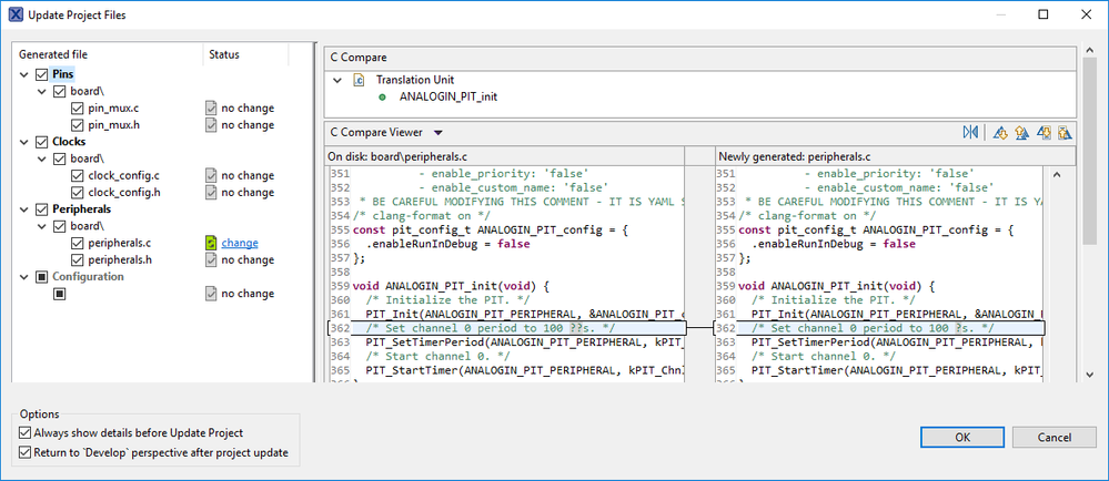

The latest MCT in MCUX 10.3.1 seems to have an issue with UTF-8 characters.  I have a Kinetis K24 project with SDK 2.5.0, and I've configured the PIT peripheral and a single channel.  But when I regenerate my peripherals.c, exit, and come back, MCT thinks I need to regenerate my code again because one of the documentation comments has supposedly changed.  Here's the actual code:

See line 39 there?  MCT inserted the comment "Set channel 0 period to 100 microseconds", using Greek "mu" for "micro", which is correct.  The "mu" displays correctly in the Eclipse editor window and in my third-party text editor.  However, MCT doesn't know how to handle this when determining whether to regenerate the code.  peripherals.c is always flagged for regeneration because of that line.  If I click the green "Update Project" button, then click the peripherals.c "change" link to compare what's changed, this is what I see:
It's not reading the UTF-8 "mu" correctly, so it shows two question marks in the "on disk" box, and one question mark in the "newly generated" box.
I don't know if this is an Eclipse issue with UTF-8 compatibility, or if this is purely an NXP software component, but either way, this is rather frustrating, because there's no workaround; even if I hand-edit peripherals.c to use the Latin "u" instead of Greek "mu", MCT is still going to flag peripherals.c for regeneration.  Any chance you can fix this in the next release?

Just to continue with the follow up, from internal team:
This has been fixed as a software bug and the updated config tool will be released together with SDK 2.6, which will be available on 6/6/2019 as estimated.
