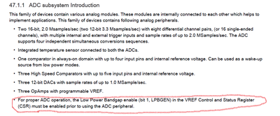

On the LPC553x system I am using, the ADC has terrible results unless the internal VREF module and the low power bandgap is enabled prior to use of the ADC module. I initially did not turn on the VREF module because my board design uses an external reference through the VREFP pin.
I suspect the voltage reference must be used in the autocalibration process or somewhere internally in the SAR conversion. This is fine, and it's now documented in revision 2 of the processor family reference manual, but the Config Tools code generation interface doesn't warn you of this when instantiating just an ADC module.
Interestingly, if I drop the ADC module clock rate to 8MHz I can get usable results out without enabling the bandgap reference.

Regarding your question, even if you do not use the on-chip Voltage Reference as ADC voltage reference, you have to configure the on-chip Voltage Reference.
This is the ADC code for the LPC5536:
/* Disable VREF power down */
POWER_DisablePD(kPDRUNCFG_PD_VREF);
VREF_GetDefaultConfig(&vrefConfig);
vrefConfig.bufferMode = kVREF_ModeBandgapOnly;
vrefConfig.enableInternalVoltageRegulator = false;
vrefConfig.enableVrefOut = false;
VREF_Init(VREF, &vrefConfig);
Regarding the ADC clock, I suppose that the 8MHz is too slow. This is the value you should set up:
Regarding the ADC result which is not stable, I suggest you set a big value for the g_LpadcCommandConfigStruct.sampleTimeMode = kLPADC_SampleTimeADCK131;
