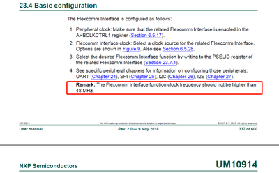

ZhangJennie
Hi andreasruetten,
According to UM10914
"The Flexcomm Interface function clock frequency should not be higher than 48 MHz."
That's why we can't set Flexcom clock higher than 48Mhz in Configuration tool.

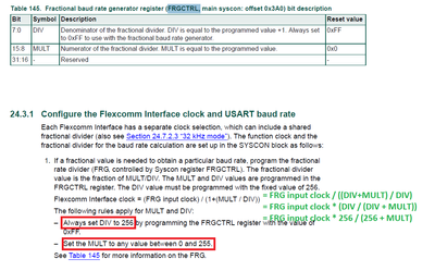

marek_neuzil
Hello Andreas,
Let me explain the problem of the fractional divider of the LPC5411x MCU. The description of the functionality is little bit confusing in the user manual UM10914. You can find the following description of the FRGCTRL and also the functional description of Flexcomm fractional rate divider:
As you can see, when you transform the expression, there is fixed multiplicator 256 and divider with range 256 - 511. This is the functionality that is provided in this MCU.
I have checked the possibilities of the Flexcomm fractional divider and System PLL. If you need both the PLL output and main_clk to be 120 MHz the fractional divider cannot be used to divide the 120 MHz to 48 MHz (or lower). This combination of setting is not support on this MCU.
If you just need the PLL output 120 MHz and main_clk can use different clock source (for example the external clock source 20 MHz) the FRGCLKSEL can be use to select the main_clk and the fractional divider can be set to provide a requested frequency for the FLEXCOMM peripheral.

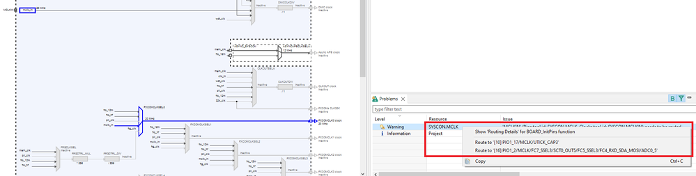

andreasruetten
Hi Marek,
Data Sheet :
mclk_in The MCLK input function, when it is connected to a pin by selecting it in the IOCON block
Does this mean, that it could be any IO Pin ?
But i need 2 Pins, Right?
One mclk_in  pin and one CLK_IN  pin ...
Andreas
4,014 Views
marek_neuzil
Hi Andreas,
Yes, you need two input pins if you want to use the mclk_in as a reference clock source for the FLEXCOMM0 peripheral.
When you enable the mclk_in clock source the following warning is reported and you can use the context menu of the warning to route a pin for the mclk_in. The initialization code is provided (generated) in the Pins tool. You can select one of two routable pins for the mclk_in.
See the following screenshot:
