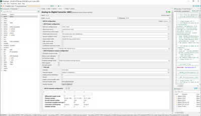

Hello, I'm using microcontroller K32L2B21VFT0A (without MCUxpresso IDE), and I have to configure 3x ADC0 channels.
I also need to use these 3 channels asynchronously, trigerred by SW.
My questions are:
1) Is that possible to read simultaneously these 3 ADC0 channels by using DMA?
I saw that MCUXpresso config tools v9.0 generates erroneously the following code,
by missing the third channel. I configured 3 channels, but instead 2 channels are read in the auto generated code:

I would like to ask if it's some HW limitation that i have to consider when using this specific microcontroller,
or it's just a wrong parameterization that I can set manually from 2 to 3.
In K32L2B21A.h there is a define "#define ADC_SC1_COUNT (2U)" that fixes this restriction to 2 channels. Is it a wrong value, or the channels are indeed limited to 2?
2) by using the auto generated code for reading out the 3x ADC0 channels, i am able to obtain values only for the first channel.
The values read from the other channels remain 0.
Is there some example code for DMA reading simultaneously all these 3 ADC0 channels?
Is the auto generated poposed code correct? Is it OK to read in a loop all these 3 channels of ADC0?
Or i have to read them sequentially, by reading only one ADC0 channel per interrupt?
3) In the documentation is written: "Channel group 1 and greater indicates multiple channel group registers for use only in hardware triger mode" (https://mcuxpresso.nxp.com/api_doc/dev/210/group__adc16.html#ga7b953a868efa27473910b72d7f80287c)
Does it mean that I can't use SW trigerring mode for reading all these 3 channels of ADC0 in one common interrupt for ADC conversion completion like this?
ADC16_SetChannelConfig(ADC0_PERIPHERAL, ADC0_CH0_CONTROL_GROUP, &ADC0_channelsConfig[0]);
ADC16_SetChannelConfig(ADC0_PERIPHERAL, ADC0_CH1_CONTROL_GROUP, &ADC0_channelsConfig[1]);
ADC16_SetChannelConfig(ADC0_PERIPHERAL, ADC0_CH2_CONTROL_GROUP, &ADC0_channelsConfig[2]);
where the three control groups are the same value, equal to 0.
If that's not possible, would you please suggest me some example or code to resolve this issue?
If I replace SW trigerring of ADC0 channels by HW one on a fixed period, would it fix my problem?

Hi nre,
I think the auto generated code is fine. ADC_SC1_COUNT means there are two SC1x register, SC1A and SC1B. Channel group means you can assign each channel to SC1A or SC1B in software. Here are some examples.
https://community.nxp.com/t5/Kinetis-Microcontrollers/MKL17Z32VLH4-multiple-19ch-ADC-with-DMA/m-p/10...
https://community.nxp.com/t5/Kinetis-Microcontrollers/Code-Example-for-ADC16-IRQ-Handler/m-p/760517
Jing
