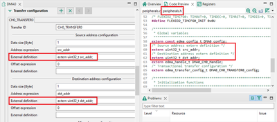

I'd like to use a variable name of the data array to be shifted out as the source address expression.   When the code is produced, this variable name is referenced in "peripherals.c" (as expected), but the compile fails due to the variable not being known.    Is there a way to add a "#include" or an "extern" declaration in the automatically generated code.   I want to avoid having to edit "peripherals.c" every time a change is made.

- In case you use DMA component in Peripherals tool, you can use the external definition settings:

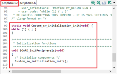

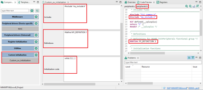

- Alternatively, you can use general custom initialization component:
