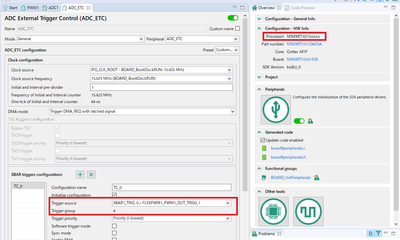

I found a strange point that occurs only when selecting RT1010 of MCUXpresso Config Tools (ADC_ETC).
Trigger group is selected as follows.
(Trigger source) → (Trigger group)
XBAR1_TRIG, 0 → 4
XBAR1_TRIG, 1 → 5
XBAR1_TRIG, 2 → 6
XBAR1_TRIG, 3 → 7
But this doesn't work.

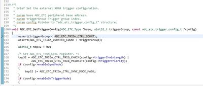

The operation is stopped by the following assertions.
Here, ADC_ETC_TRIGn_CTRL_COUNT is defined in MIMXRT1011.h as follows.
#define ADC_ETC_TRIGn_CTRL_COUNT (4U)
So Trigger Group seems to be correct at 0,1,2,3.
Actually, in the sample project "evkmimxrt1010_adc_etc_software_trigger_conv", the following is written.
ADC_ETC_SetTriggerConfig(DEMO_ADC_ETC_BASE, 0U, &adcEtcTriggerConfig);
(That is, 0 is used instead of 4.)

My main issue is the number of "Trigger group" created by the Config Tools.
I have confirmed the RM by your reply and found out.
The "Config Tools" ought to generate the value as follows:
//Current (MIMXRT1011)
XBAR1_TRIG, 0 → 4
XBAR1_TRIG, 1 → 5
XBAR1_TRIG, 2 → 6
XBAR1_TRIG, 3 → 7
//Modify
XBAR1_TRIG, 0 → 0
XBAR1_TRIG, 1 → 1
XBAR1_TRIG, 2 → 2
XBAR1_TRIG, 3 → 3
Please check it.

This assert is because i.MX RT1010 devices only have 4 trigger groups (0 to 3). You can confirm this if you check the reference manual in ADC_ETC Memory map section you will see only ETC_TRIG0 to ETC_TRIG3.
On the other hand, RT1050 families contains up to 8 trigger groups. That's why the asserted is needed to prevent Config Tools to set a trigger group that is only available in larger devices.
