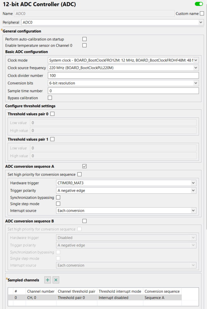

Hi everyone,
I'm a little new to this processor so bare with me. I have used the MCUXpresso to generate an ADC example with interrupt for the LPCXpresso546/540xx, from there i added a PWM @500Hz and 50% duty cycle. I then save the ADC readings in an array and stop once the array is full. The ADC sampling rate however is too slow running at around 100 sps, from which i have verified by toggling an output at the interrupt service routine. I cant seem to figure out how and where to change the sampling rate of the ADC in this example. Its just a training exercise to get more familiar, but any help would be greatly appreciated. Code is below:

Hello Blair,
The sample rate will be determined by how and when you are doing a conversion in additon to the frequency that the ADC module is running at and the sampling time. In your case the sampling time is at its shortest which is good and I can help you double check the ADC frequency if you can provide the MCU that you are using in the development board and if you are basing your initial code on an example so that I can run it from my end.
In addition there are some common practices that can help you improve the conversion rate.
1. If you are inclined in using the interruption, try to keep the interrupt handler as short as possible. Generally flags that enable or disable other functions.
2. PRINTFs will cause delays in execution as well as they are meant for debugging purposes. So if possible I recommend to keep all the information within one printf.
Another recommendation would be to consider restructuring when the conversion is made. For example if you do the conversion within the while loop of your main and with the conversion completion flag  you can enable the counter in an external function, you will have many more samples ready than how it is being done at the moment.
Please let me know if this helps, or if you have further questions.

Hi Sabrina, Thanks for your response! The MCU I am using is the LPC54628J512.
The code is a meddly of the ADC interrupt example and PWM example from the MCUXpresso Config Tools application. This was very helpful, and I was able to control the conversion rate in the end by using a timer callback to trigger every time I wanted to sample the PWM signal. However I still could use some more information on how to manually set the sample rate of the internal ADC outside of using timers like I have done now, is there any way to do this? Ideally i would like to sample the PWM signal at 5000 sps, 10 times that of the 500Hz PWM signal at 50% duty cycle.

Petr_H
I think you need to use the hardware triggering from a timer. There is possible to do some adjustment of  sampling using clock and other settings, but this would be probably too limited and hard to tune.
Do you need the sampling to be exactly synchronized with the generated PWM or is it enough to achieve the sample rate of multiply of the PWM freq as you mentioned ?
Are you using the config tools ? With using the MCUXPresso Config tools, it's to possible configure the ADC initialization and triggering  in a GUI.
