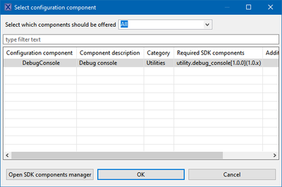

I'd like to add the Shell utility to my project. I have added it in the SDK component manager but don't have an option to add it in the peripherals configuration. What else do I have to do to enable the shell?

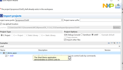

You doesn't say part number. For example for LPC55s69, we can use shell demo
Running the demo
When the example runs successfully, the following message is displayed in the terminal:
SHELL (build: Jun 19 2020)
Copyright 2020 NXP
SHELL>> help
"help": Lists all the registered commands
"led arg1 arg2":
Usage:
arg1: 1|2|3|4... Led index
arg2: on|off Led status
"exit": Exit program
SHELL>> led 1 on
SHELL>> led 1 off
SHELL>> led 2 on
SHELL>> led 2 off
SHELL>> led 3 on
SHELL>> led 3 off
SHELL>> led 4 on
LED index is wrongs
SHELL>>
1,The shell information "SHELL (build: Jun 19 2020)" may be different, which depends on the compile date.
2,If the command 'led x on'/'led x off' run success, the corresponding LEDx on board will turn on/turn off.
But the valid "Led index" may be different, which depends how many LEDs are available on the specific board.
For example: one board only have LED1/LED2, then shell demo will print "LED index is wrong" for all led index bigger than 2.
Please have a try.

Regarding the configuration in the peripherals tool - in this case the shell SDK component does not have any configuration component in the peripherals tool so it has to be initialized and configured manually in the source code.

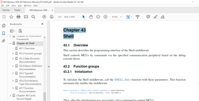

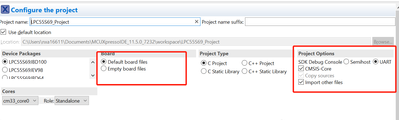

when you create a project with uart support, BOARD_InitDebugConsole is added to project
If you want to use shell, you need to add Shell component to your project.
then refer MCUXpresso SDK API Reference Manual_LPC55S69.pdf under your SDK folder. Chapter 43 Shell. This tells how to use Shell middleware.
