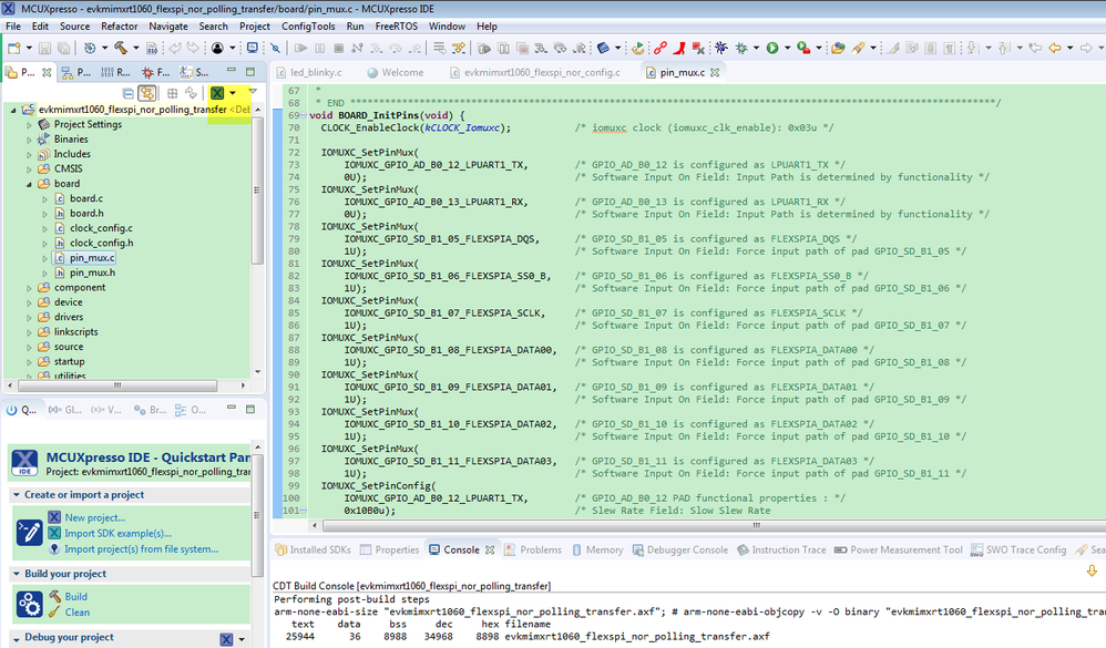

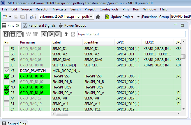

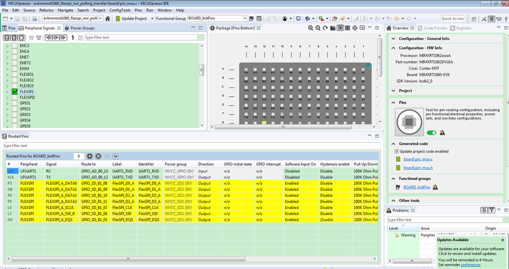

kerryzhou
Hi Reiner Fauser ,
    Please check the following picture about the FlexSPI:
So, I think you can try to use the official SDK code, then use the MCUXPresso IDE to open the flashspi_nor_polling project, in the project, you can open the config tool, you will find the FLEXSPI pin is avaiable.
Wish it helps you!
Kerry
