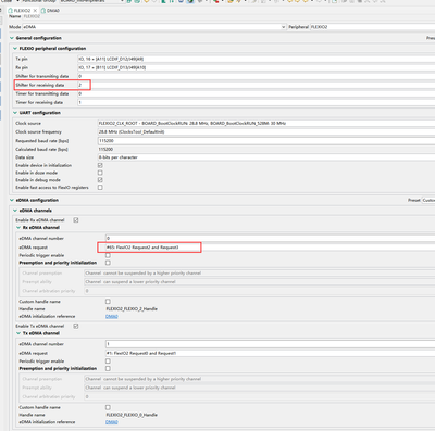

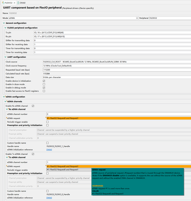

I'm using 'MCUXpresso config tools" on MCUXpresso IDE, the version is v11.81 on windows 10.
When I config UART component base on FlexIO 2 peripheral with eDMA transfer mode, on setting eDMA request there only can select "#1: FlexIO2 Request0 and Request1" for one channel.

I have found out what happen, Shifter for receiving data needed set to '2'.
