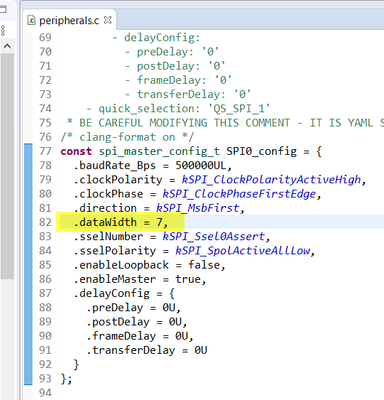

 I found a bug in the config tools, with LPC845.
MCUXpresso IDE V11.2.1
LPC845 SDK 2.8
Steps to reproduce:
- create new project for LPC845, include SPI driver
- create configuration .mex
- add SPI peripheral driver
- set "Data width [bits] = 8
- update code
Check configuration in peripherals.c
  .dataWidth = 8,
where it should be 7, according to datasheet and example. the way it is done in the SDK example is setting
dataWidth = kSPI_Data8Bits;
which is set to 7 in the enum. basically the result of using the config tools is setting the datawidth to what it is set to + 1.

It seems this bug have been fixed, I download the latest SDK, test on my side, there is
on issue:
Alice
