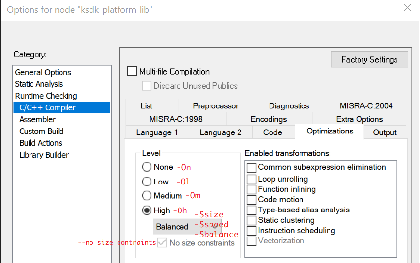

  •  SDKGEN-865Support IAR compiler optimization strategy flag for library projects
        Compiler Optimization flags are supported for IAR application and library projects:
        1. -On / -Ol / -Om / -Oh / -Oh -Ssize / -Oh -Sspeed / -Oh -Sbalance / --no_size_contraints
         2. Enabled transformations checkbox items in Optimization tab are enabled by default, each item could be disabled by adding cx-flags settings in yml:
             --no_cse / --no_unroll / --no_inline / --no_code_motion / --no_tbaa / --no_clustering / --no_scheduling
             Note: Vectorization setting is to enhance DSP performance for Arm Cortex-A NEON units, not supported now.

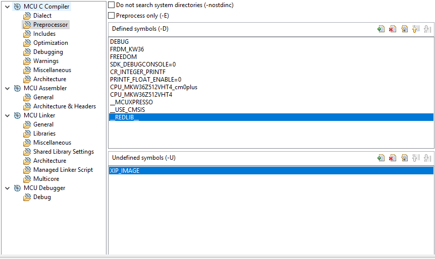

         mcux-undefine tag has been enabled in yml setting for Mcuxpresso IDE.
         For example:
         In yml file:
         And this macro will show in Undefined symbols:
