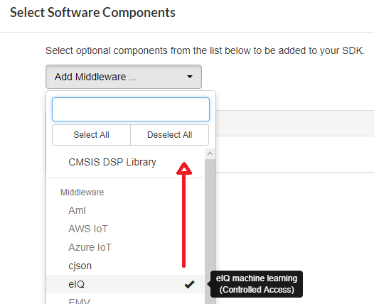

Such dependency will be reflected on the MCUXpresso website and also in the SDK manifest file:

How to verify that the dependency has been correctly described it will really work in the SW tools?
  1. You can generate an SDK package with this component and check the behavior in the MCUX IDE.
  2. You can check SDK release data tables - output of the first two stages of the SDK Generator, where the component dependencies are resolved:
    1. Run “ruby all_evkxxx.rb -a eiq -c superset -o target_dir“, in the target_dir/devices/<xxxx>/<xxxx>.yml, you can check under your middleware.eiq.ui_control, it should have the “CMSIS_DSP_Lib.ui_control” in the “web_requires”, like
