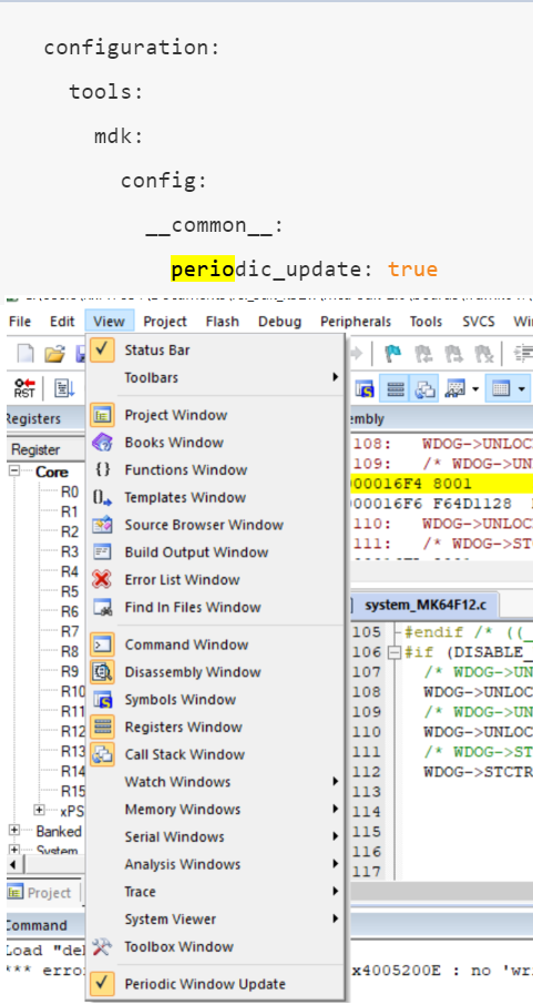

  •  SDKGEN-1389Support Periodic Window Update feature for Keil
        Variables will update periodically if View – Periodic Window Update is selected when debugging. To enable or disable this option, a tag named "periodic_update" should be set in yml. Besides, a .uvoptx template file must be set, or this setting can not take effect.
For example:
