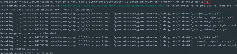

  • SDKGEN-778 Support to dump minimum merged yml information without generating all IDE projects by passing parameter “-d”
       To quickly parse SDK examples list for the special board then create CI test scope, you can get a minimum merged         yaml information that dumped by SDK generator script with "-d" parameter.
       The minimum information include:
  • All "document" node info
  • "outdir" info
  • Simplified toolchains and configurations supporting list
  • "section-type" and "required" info
        Here is the running example:
