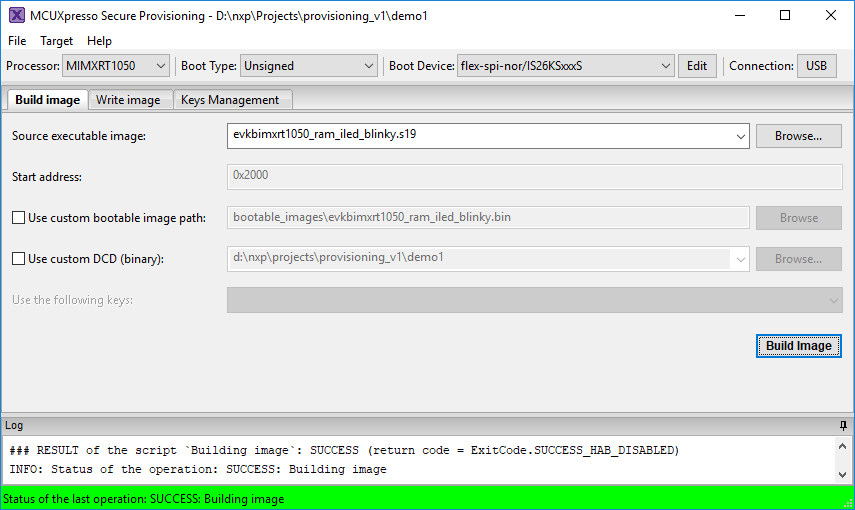

We are pleased to announce that MCUXpresso Secure Provisioning Tool v1 is now available.
MCUXpresso Secure Provisioning Tools is a graphical user interface (GUI) tool covering the secure boot
process, aimed primarily at microcontroller customers. It provides unified GUI front-end over existing
command-line tools - FlashLoader, elftosb, blhost, cst.
Features
  • Support for i.MX RT1050 and i.MX RT1060
  • Unsigned, HAB signed and HAB encrypted Secure Boot modes
  • Conversion of ELF executables, SREC and raw binaries into bootable images files
  • Generation and management of keys, signatures and certificates associated with the image
  • Connectivity to the target via UART, USB-HID.
  • Writing FlexSPI NOR or SD card boot device including configuration of the boot device parameters
  • Use of DCD configuration enabling booting into SDRAM images
  • Programming eFuses per image and use case requirements
  • Optional generation of batch scripts usable later without the GUI
  • Streamlined operation for general users
