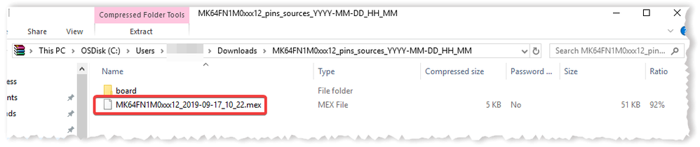

  • The resulting archive will include your MEX configuration.pastedImage_70.png

  • Here you can specify the name your configuration if needed and click ‘Finish’ button at the bottom.
  • The resulting archive will include your MEX configuration.pastedImage_75.png
