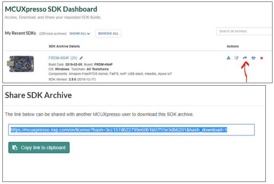

Please, share the YML file and the SDK package (links to those files). BTW, you can use a SDK package share link feature to get the SDK package link:
