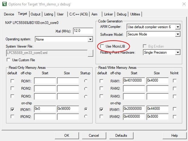

Is there any way to disable/enable "Use MicroLIB" in Keil project, using the MCUX generators?
We need to disable MicroLIB (in template is enabled), mainly cause of missing exit() required for ARM TFM middle-ware project.

Found the answer in older post on this forum :smileyhappy: https://community.nxp.com/docs/DOC-342143

Hello Andrej,
    In our doc: Yml data record guide.md, in the chapter "MicroLIB for keil", you can also find the answer☺.
