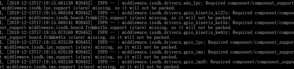

New features update:
  • SDKGEN-644 Give log message in debug level when some section do not meet dependency
    • Now user can easily get which component/application is not packed and the unpacked reason.
Generator will log info on terminal when doing the dependency analyze, user can easily get which application or component is not packed and why by setting the logger level to info which is '-l 1' like "ruby sdk_frdmk64f.rb -c superset -o -l 1" to get the log message such as:

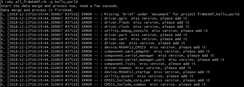

  • SDKGEN-604 Give error message when project data misses some required attributes
    • Generator now supports to check the required attributes and log on terminal if any attributes are missing. Here is the checklist:
      • brief.    It is a required attribute for CMSIS pack(schema).
      • version.    It is a required attribute for both manifest and CMSIS pack(schema).
      • category.     It is an optional attribute for manifest(schema).
Please update the ymls when you see these warns/errors which usually cause troubles in package use.
Here is one example:
