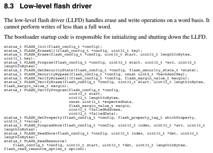

sorry ,maybe i said what is not clear, in fact ,i want to know  low -level flash driver:
now i'm porting kboot to one it is  not from kinetis,so should i creat new low-level flash driver for it .or maybether sre  other easy and simply methods. i find flash driver fsl_flash  in NXP_Kinetis_Bootloader_2_0_0\src\drivers ,but they can't be used for my mcu .

victorjimenez
Which MCU are you trying to use? It's not recommended to migrate kboot to other MCU that is not from the Kinetis family. In the application layer maybe everything can remain the same, but at a lower level you need to change everything according to the MCU you want to use.

victorjimenez
Since kboot was made for Kinetis family devices only. If you want to migrate kboot to other MCUs you will need to modify the physical layer depending on the MCU that you want to use. So, you will need to read the reference manual of each MCU to see how you need to modify the physical layer.

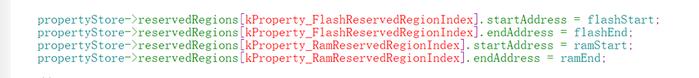

676638449
hello  Victor
I meet a problem about source code. 捕获.PNGThis code is in line 227 of property.c. I don't understand why the start and end addresses of the reserved area are the start and end addresses of flash. When I want to erase a certain sector of flash, mem_is_block_reserved() is called. , but this function will return true, then mem_erase() returns kstatusMemoryRangeInvalid. I hope you can answer my doubts.

victorjimenez
Sorry for my late response.
Kboot only reserves the flash memory that is needed to store the bootloader, it doesn't reserve all the Flash. Keep in mind that if you want to erase a sector of flash then you cannot be running that command from the flash memory.
